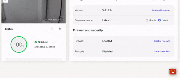

In the Digital Factory, admins can set extra security measures for connected and shared printers, such as enabling a firewall and setting an access PIN code.
Enable printer firewall
The firewall will block all unsolicited local network traffic on your printer. This means that users on the local network will not be able to discover the printer using UltiMaker Cura. The printer will also not be able to receive any print jobs via the local network. The printer is effectively secured from any local network activity.
You can enable the firewall via the printer's display or via the Digital Factory. Only admins have the right to change security-related features such as the firewall. In the Printers panel, select the printer for which you want to set the firewall. Then, go to Settings, scroll down to Firewall and security, and select Enable Firewall.
Tip: For more information about the firewall, visit this page.
