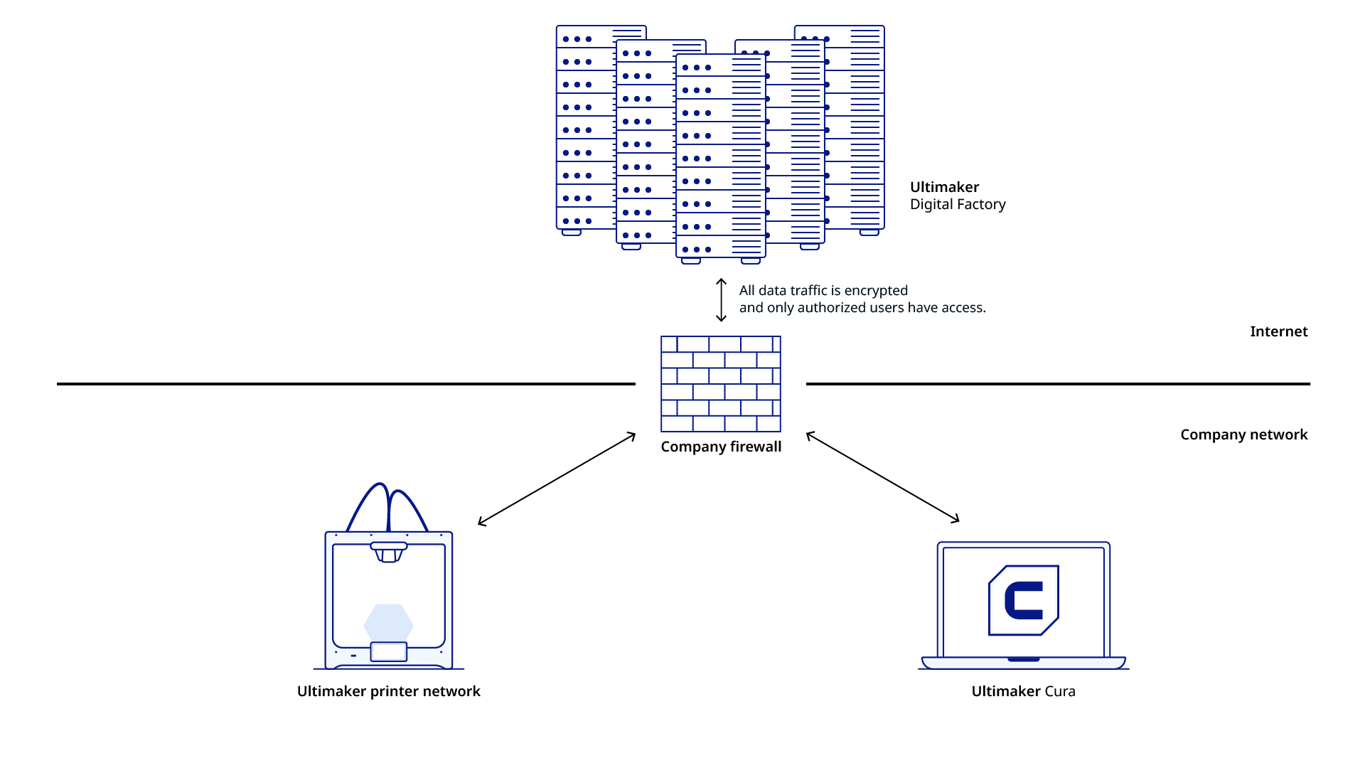

  • UltiMaker printers and Cura desktop software rely on Digital Factory for security functions as both the printer and Cura are open by default. When printing via Digital Factory, the level of security can be increased. More details are available in later sections of this article.
  • UltiMaker applies the Principle of Least Privilege (PoLP) in customers functions, but only when printing via Digital Factory (admin, member, and guest users with different levels of authorization). More details are available in later sections of this article.

By default –and by design– UltiMaker 3D printers are open. Anyone with physical or network access has full control over the printer. To increase the level of security, you should activate the firewall on the UltiMaker 3D printer and protect your 3D printer settings by using the UltiMaker Digital Factory. Please refer to UltiMaker security functions for more details.
Note: Exception is for the UltiMaker 2+ Connect, which only supports printing via UltiMaker Digital Factory (or USB) and has an active firewall by default.

There are known vulnerabilities for the connection between UltiMaker Cura and printers directly over the local network. Please note the following vulnerabilities are by design and will not be resolved:
The local connection is not encrypted. Customers are recommended to use the UltiMaker Digital Factory to secure the connection between UltiMaker Cura and printers, and also to activate the firewall.
There is no authorization in place. Anyone with access to the same network segment can access the printer web server and APIs. Customers are recommended to use the UltiMaker Digital Factory and to activate the firewall if only authorized users should have access to the printer. As an alternative customers might also apply local mitigation to limit printer access
Similar recommendations apply for CVE-2021-34086 and CVE-2021-34087. Customers using the UltiMaker Digital Factory and with active firewall on their printers are not exposed to these vulnerabilities. Customers might also apply local mitigation to limit printer access.
Customers should at no point expose UltiMaker printers outside of their network firewall.
