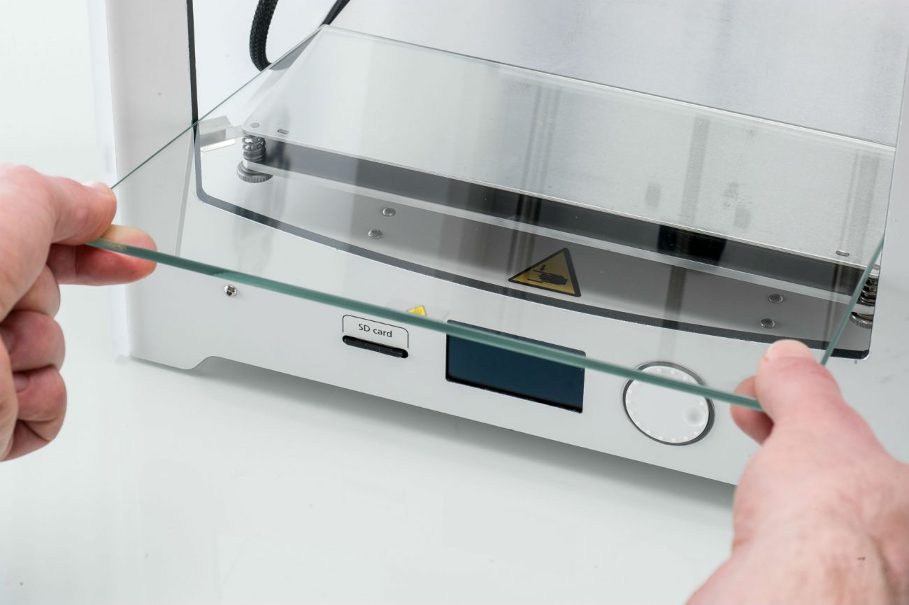

Before starting a new print, always check the surface of the build plate. At least once a month, clean the build plate thoroughly by taking the following steps:
Remove the glass plate
Ensure that the build plate is at the bottom of the printer. Open the two build plate clamps at the front and slide out the glass plate.
Note: Do not lift up or tilt the glass plate until it is out of the build plate clamps at the back to prevent damaging them.

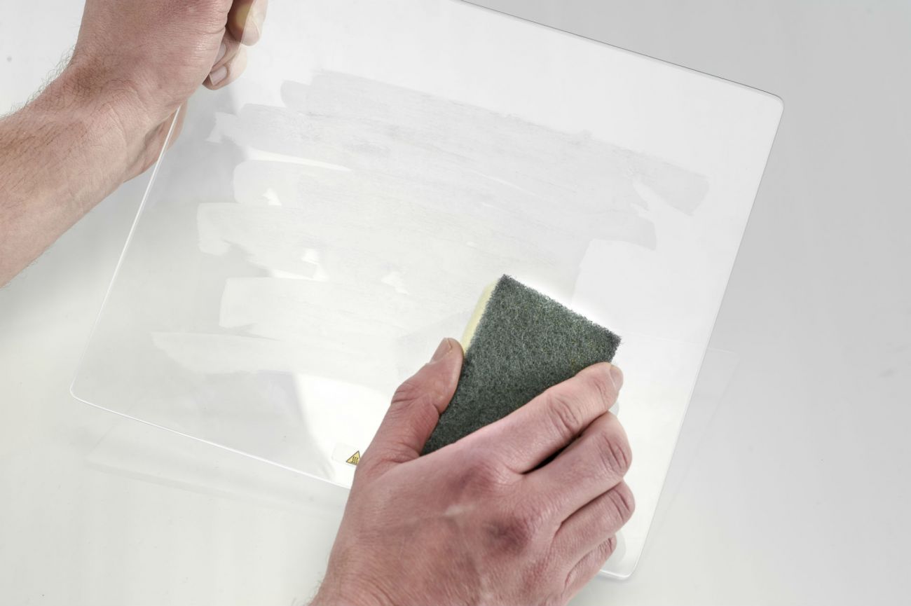

Clean with water
Use lukewarm water and a non-abrasive sponge to clean the build plate and remove any adhesives. If necessary, some detergent can be used to remove adhesives, or alcohol gel can be used to get rid of any fatty substances
Dry the plate
Leave the plate to air dry, or wipe it down with a microfiber cloth. Ensure that the plate is fully dry before reinstalling it in the printer.
Apply a layer of glue
For most materials, it is recommended to apply a thin layer of glue to the glass plate. This improves the adhesion of printed models to the build plate.
Reinstall the glass plate
Slide the glass plate back into the printer until it snaps into the build plate clamps at the back. Close the front two build plate clamps to secure the glass build plate.
Cleaning_Ultimaker2__Removing_glass_plate.jpgCleaning_Ultimaker2__Cleaning_glass_plate.jpg
Remove the glass plate from the printerClean the glass with a sponge
Tip: To ensure good adhesion of your next print, it is recommended to re-level the build plate after repositioning the glass plate.

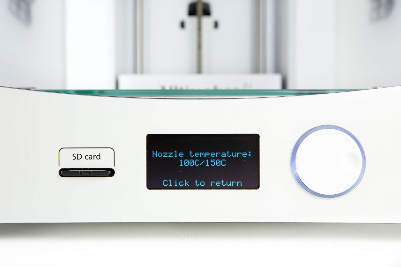

  1. In the menu, navigate to Maintenance, then Heat up nozzle.
  2. Rotate the controller button to set the target temperature to 150 °C.

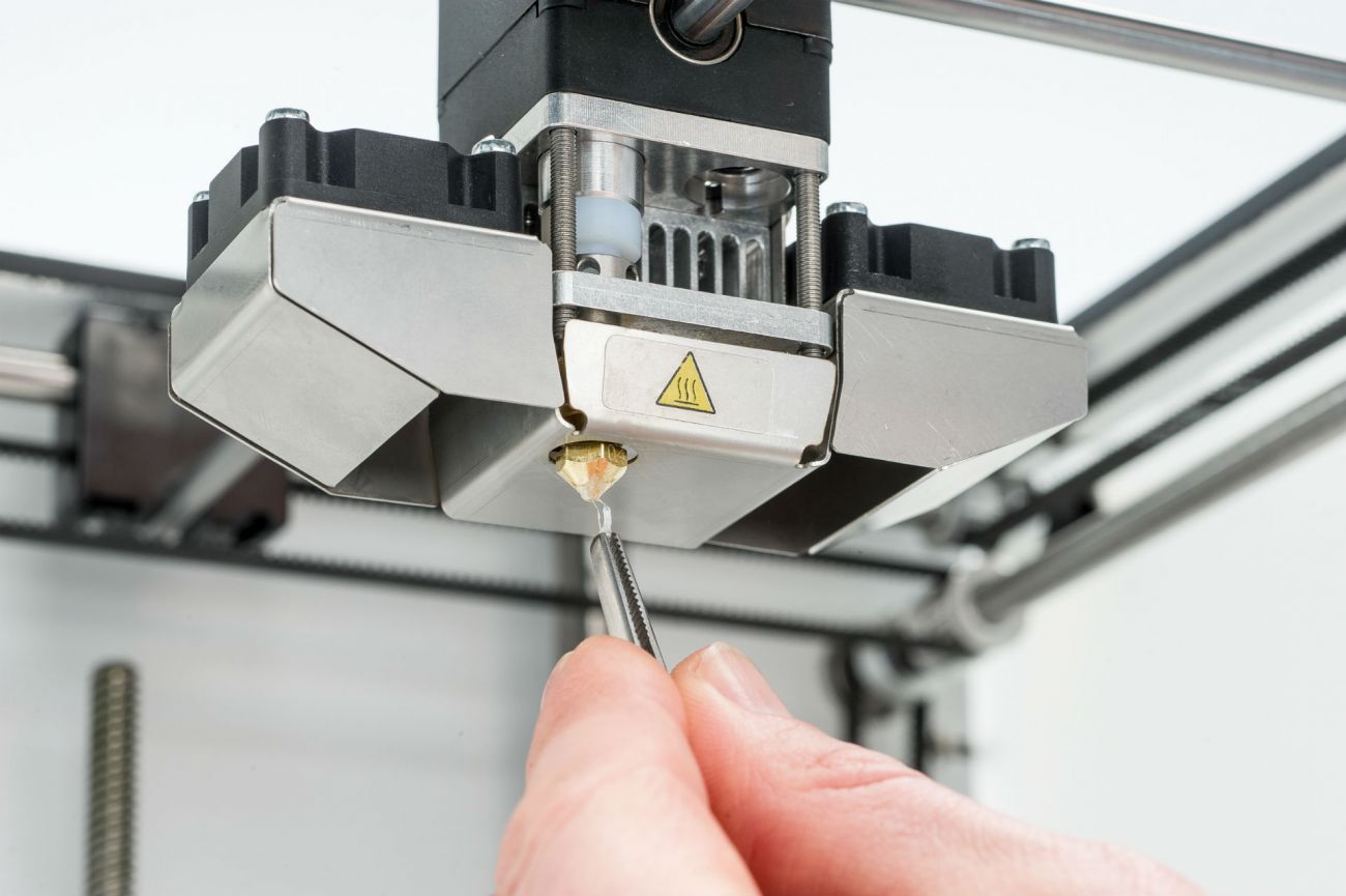

  3. Wait for the material on the outside to soften. When the nozzles are hot, carefully remove the material with tweezers.
  4. Lower the nozzle temperature to 0 °C and wait for the nozzle to cool down.

Set the nozzle temperature to 150 °CRemove the soft material with tweezers

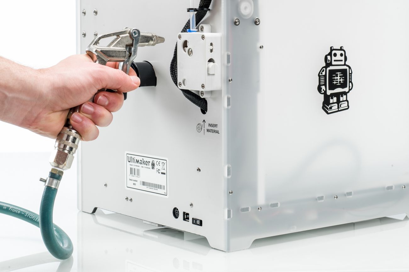

To clean the inside of the feeder, you can blow into the hole in the front of the feeder housing. If necessary, you can use compressed air. This will remove the majority of filament particles.

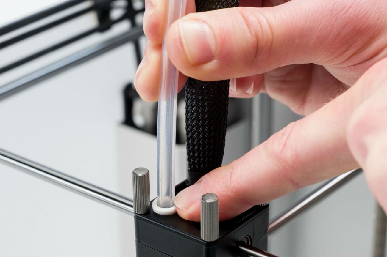

Remove the clamp clips from the tube coupling collets at the print head and feeder, and pull out the Bowden tube from both ends. The cable clips that hold the Bowden tube to the print head cable do not have to be removed; you can leave them in place.

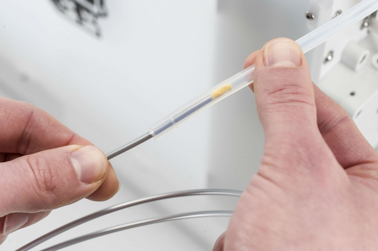

Push a small piece of sponge or tissue through the tube with a length of filament until it comes out of the other side. Ensure that any debris from the tube does not fall inside the printer.

Push the ends of the Bowden tube back into the print head and feeder. Ensure the tube is fully inserted and secure it with the clamp clips.

Remove the Bowden tubeClean the tube with a piece of sponge

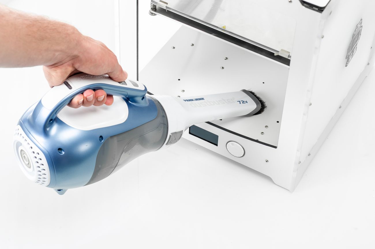

Inside of the printer
Small pieces of material can gather inside the printer. Leaving larger objects on the bottom panel can lead to errors, as they prevent the build plate from homing properly. Remove small particles regularly from the inside of the printer by taking the following steps:
Raise the build plate
You can lift up the build plate manually, or do so via the Ultimaker 2+ menu. In the Maintenance menu, select Raise build plate to raise the build plate all the way up.
Clean the bottom panel
Clean the inside of the printer with a microfiber cloth or (handheld) vacuum cleaner. Remove all dust and pieces of filament. Pay extra attention to the area around the Z limit switch as obstructions here can cause print problems.
Lower build plate
Lower the build plate again. You can do so manually or via the Maintenance menu by selecting Lower build plate. This will lower the build plate back to the home position.
Caution: Before lowering the build plate, make sure the printer is clear from objects and hands to prevent them from getting stuck under the build plate
