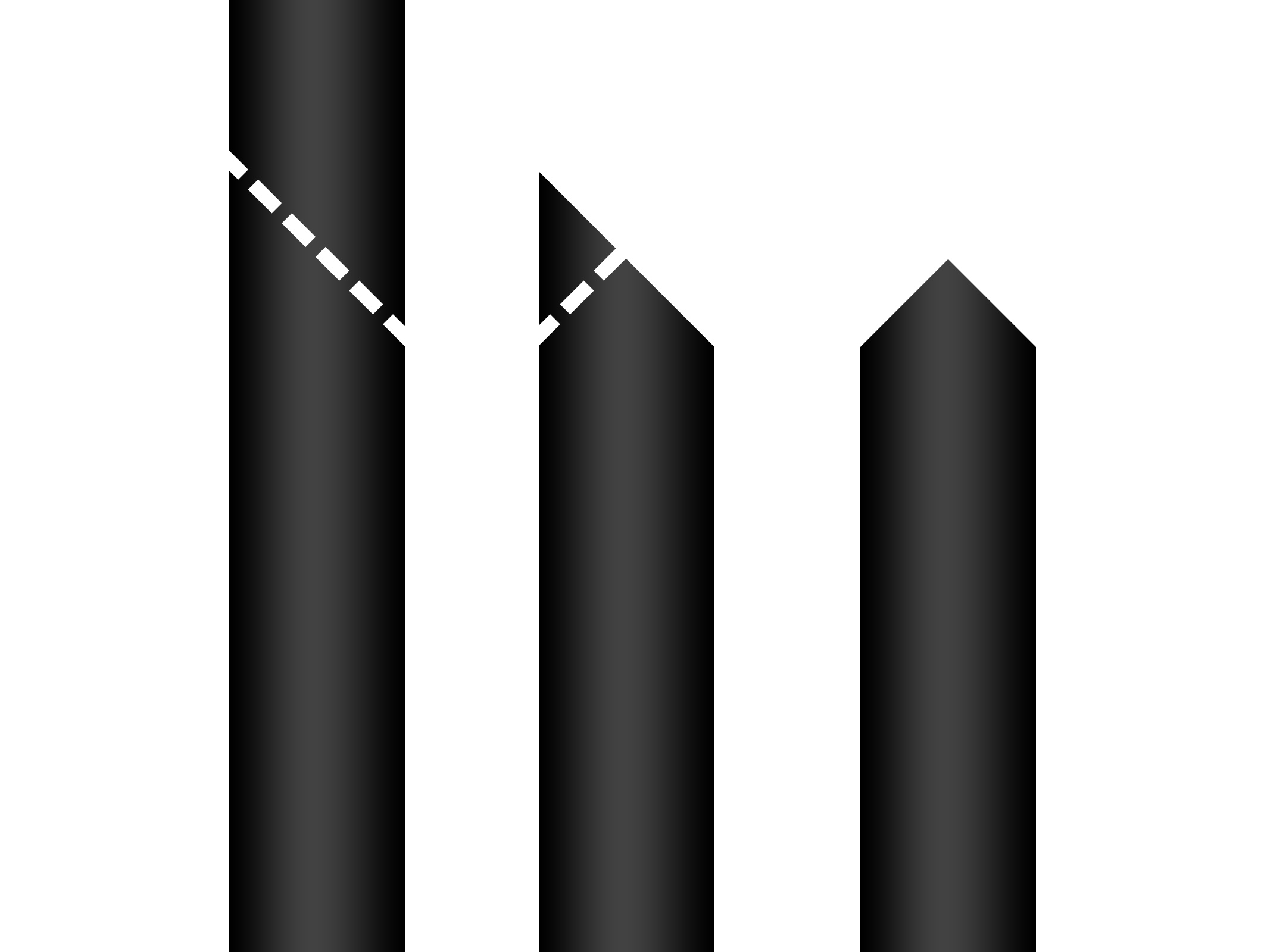

  • Cut the filament: Before inserting the filament into the Material Station entry port (pre-loading), cut the end of the material into a short, sharp tip. Use wire cutters or cutting pliers to make a double cut. Alternatively, use a pencil sharpener to get a perfect conical tip (for non-flexible filaments).
