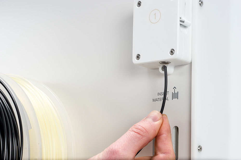

1. Unload materials
In the Configuration menu, select Unload for both materials. Take the filament out of the feeders. You can, but do not have to, remove the spools from the spool holder. In combination with the Material Station, unload any materials still in the print head back into the Material Station.

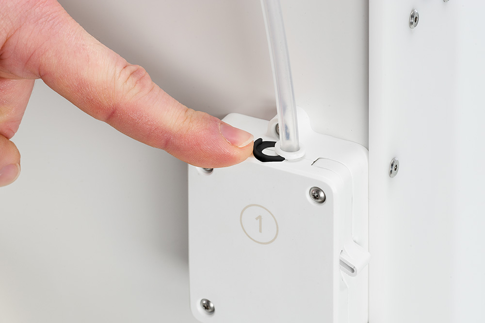

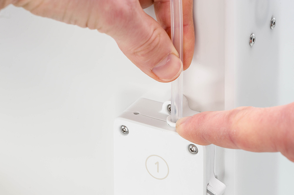

2. Remove feeder clamp clips
At the back of the printer, remove the clamp clip from the tube coupling collet at the top of the feeder. Do this for both feeders.
3. Remove feeder Bowden tubes
Press down on the tube coupling collet while pulling the Bowden tube out of the feeder. Do this for both feeders.

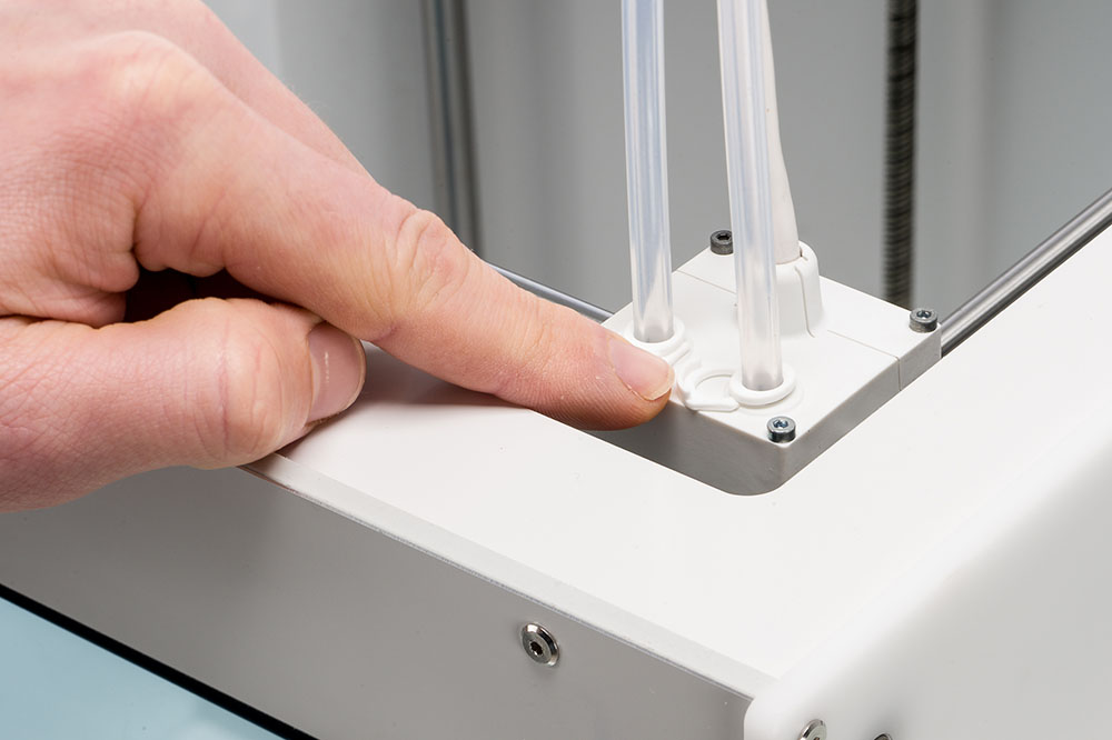

4. Remove print head clamp clips
Move the print head to the front for easier access and remove the clamp clips from around the tube coupling collets.
5. Remove print head Bowden tubes
Press down on the tube coupling collet while pulling the Bowden tube out of the print head. Do this for both sides.

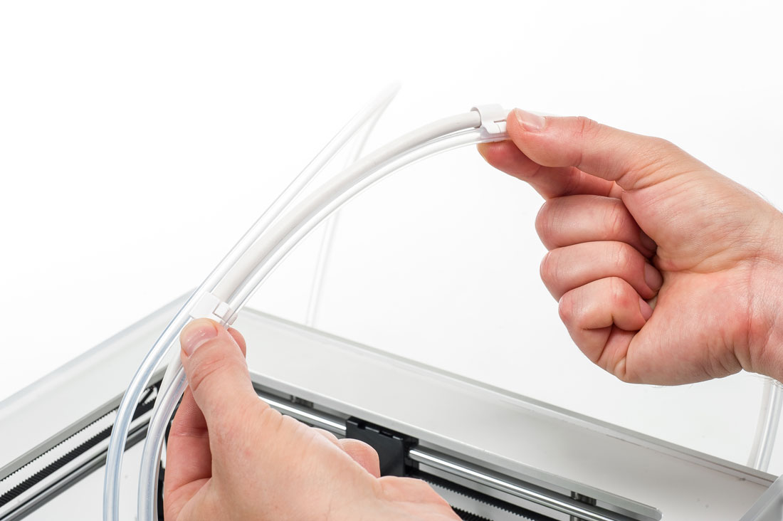

6. Loosen cable clips
When removing the Bowden tube from extruder 2 (right), loosen the four cable clips from the Bowden tube to remove it completely.
Tip: With the Air Manager (add-on), guide the Bowden tube(s) through the slots in the mounting bracket. For the UltiMaker S7 and S8 (with integrated Air Manager), guide the Bowden tube(s) through the Bowden cover(s).

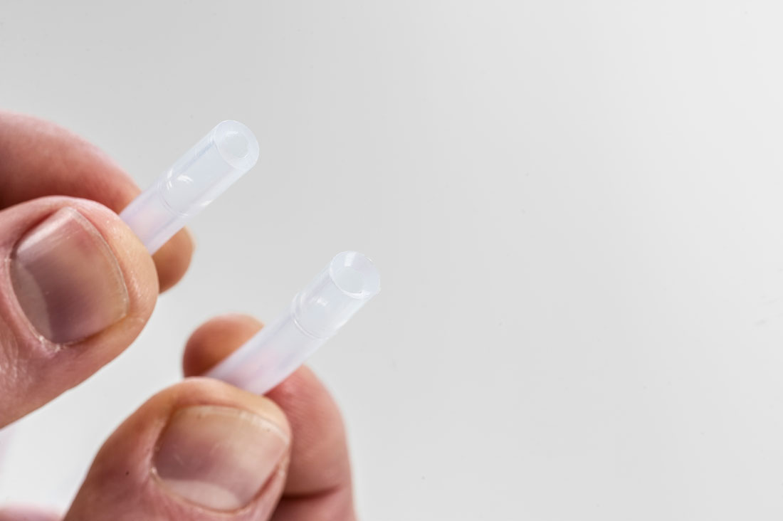

1. Check the chamfers
Both ends of the Bowden tubes should be chamfered, so the orientation does not matter. If there is a flat side, this may be an older revision. This is no problem, just ensure to insert the chamfered side in the feeder and the flat side into the print head.

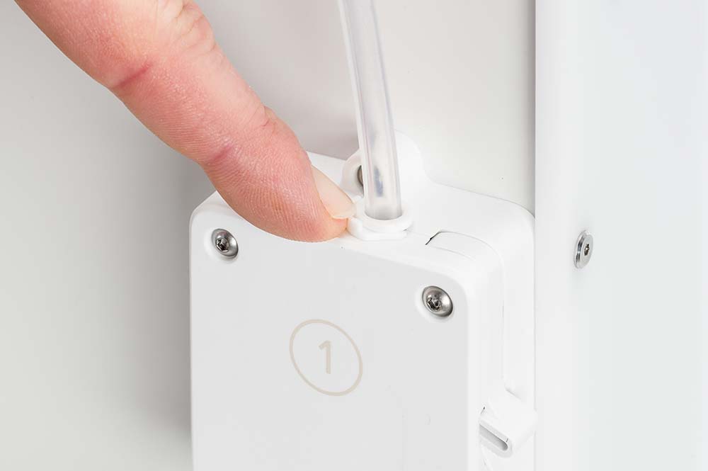

2. Insert into feeder
Insert the Bowden tube (chamfered side) into the feeder. Keep the collet pressed down and push the Bowden tube all the way in. Secure the tube with the (black) clamp clip.
Tip: With the Air Manager (add-on), first guide the tube from above through the slot in the mounting bracket. For the S7 and S8, guide the tube through the Bowden cover; this can be done from the inside or the back of the printer, whichever is easier.
3. Insert into print head
Insert the other side of the Bowden tube into the print head. Keep the collet pressed down and push the Bowden tube all the way in. Secure the tube with the (white) clamp clip.

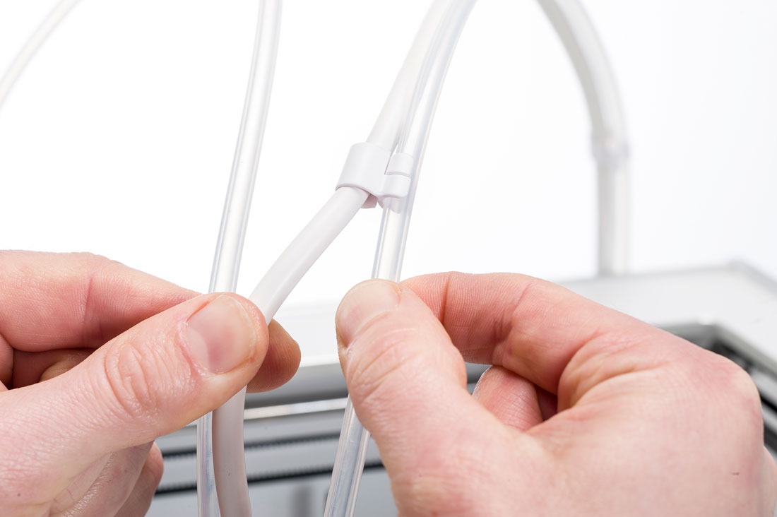

4. Place cable clips
For Bowden tube 2 (right), click the header cable clips from the print head cable onto the Bowden tube. Equally divide the clips over the Bowden tube, starting at ~10 cm above the print head.
Tip: For the UltiMaker S7 and S8, also secure Bowden tube 1 (right) to the print head cable with one clip, 15 cm above the print head.
