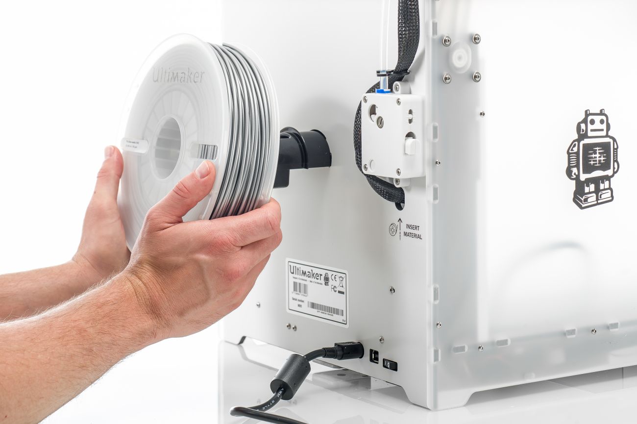

Place spool
Remove the packaging from the spool of material. Cut off the end of the filament that is hooked onto the spool. Ensure a nice, sharp tip for easy loading. Also, straighten the end of the filament so it can easily enter the feeder.
Place the spool on the spool holder at the back of the printer. Ensure that the filament is coiled towards the bottom of the feeder. On the Ultimaker 2+ and Ultimaker 2 Extended+, this means the filament must be in a counterclockwise direction.
Wait a moment for the nozzle to heat up.

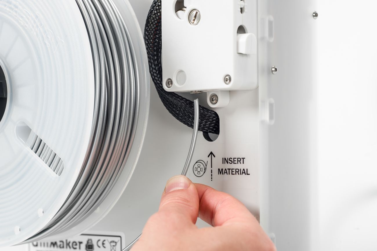

Insert filament

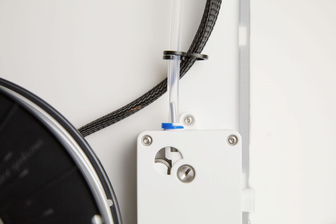

The feeder will start turning slowly. Insert the end of the filament into the bottom of the feeder. Apply pressure until you feel that the feeder grips the material. The filament will now automatically slowly move upwards.
As soon as the filament is visible in the Bowden tube above the feeder, confirm this using the button.
Note: Do not wait too long with pressing the controller button. After this, the printer will automatically forward the filament to the print head. If the material is too far into the Bowden tube, the material will jam in the hot end, and the feeder will grind into the filament.

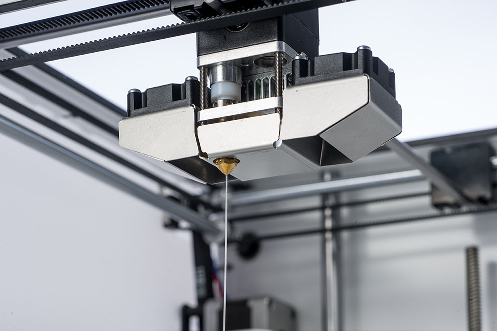

The filament will now fast-forward through the Bowden tube to the print head. When it almost reaches the nozzle, the feeder will turn slowly again.
Wait for material to extrude from the nozzle.
Note: The color of the material that starts extruding could be different from the color of the material that you just loaded. There can be some residue from the factory test print left in the nozzle. Wait until you see the color of the filament that you loaded coming out of the nozzle.
Confirm when the material is flowing consistently from the nozzle. Remove the strand of filament from the printer.
