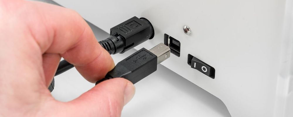

Connect to a computer
Ensure that the Ultimaker 2+ is turned on. Use the supplied USB cable to connect your Ultimaker 2+ to a computer or laptop that has UltiMaker Cura installed. This will allow Cura to communicate with the printer.
