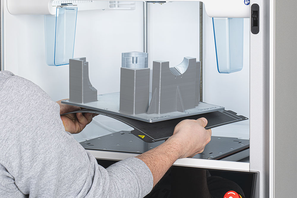

  1. Open the glass door(s).

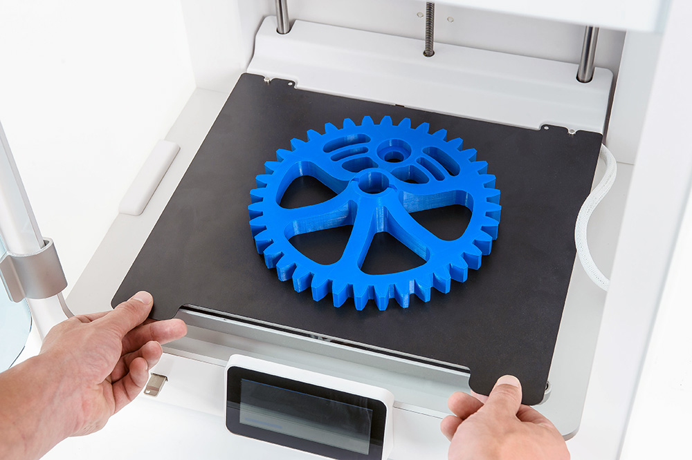

  2. Hold the flexible build plate at the tabs at the front, lift it up, and slide it out of the printer.

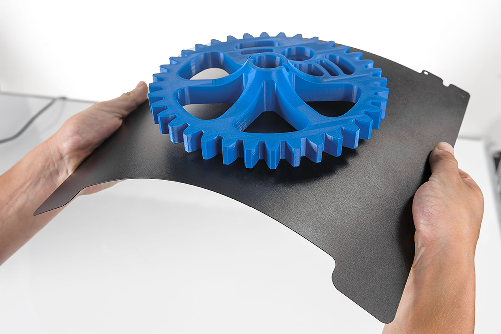

  3. Carefully bend the plate underneath the printed object until it detaches from the build plate.
Tip: Take measures to prevent the printed object from falling and getting damaged when removing it from the flexible build plate.

Place the clean flexible build plate back in the printer; learn how in this article. When the plate is installed correctly, select Confirm removal on the printer's display. This will allow the next print job to start.
