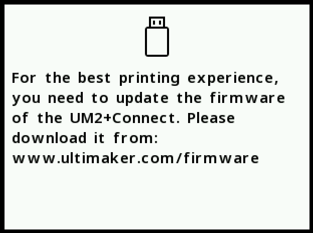

Note: When booting up your UltiMaker 2+ Connect for the first time, it is possible that you will see the screen shown below. This only applies to printers manufactured in 2020. If this is the case, you must first install the latest firmware via USB before you can continue to use the printer.
If you see this screen on your UltiMaker 2+ Connect, follow these steps:
  • Download the latest firmware file via the link above.
  • Place the file in the root directory of a USB stick.
Note: Do not make any changes to the file or filename.
  • Ensure the UltiMaker 2+ Connect is powered on and displaying the screen shown above.
  • Insert the USB stick into the USB port at the front of the printer to automatically start the firmware update.
Wait for the printer to finish updating the firmware. The printer will restart.
After installing the firmware according to this procedure, you are ready to complete the set-up for first use. Any future firmware updates can be performed via network or USB as described above.
