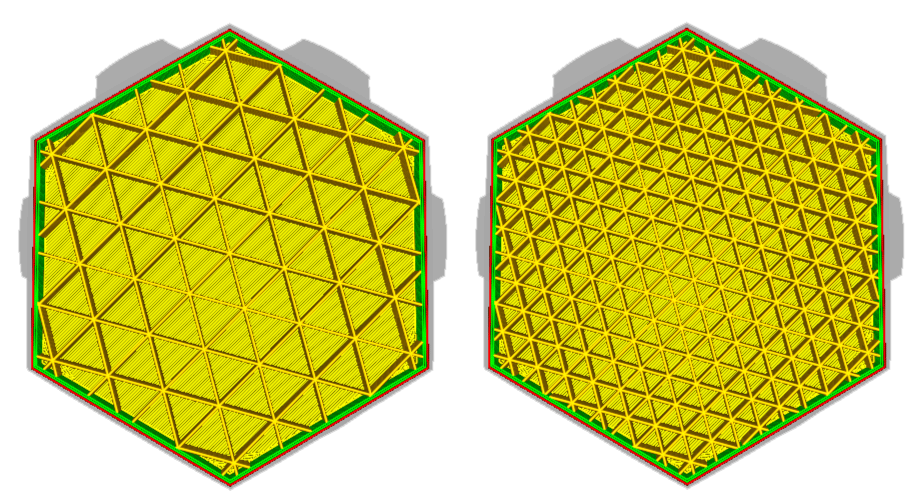

Connect Infill Polygons
When the infill consists of closed loops, these closed loops can be fused together to form one single loop. Enabling this setting will make small connections where polygons are adjacent.
This setting is only available when the infill consists of loops that are adjacent to each other. That means that either:
  • The infill pattern is set to Cross or Cross 3D.
  • The infill lines are multiplied to an even number (see Infill Line Multiplier below).
  • There are at least 2 extra walls around the infill (see Extra Infill Wall Count below).
The aim of this function is to prevent travel moves. The final line will be one single loop for every connected part of infill, so there will not be any travel moves. This makes it easier to work with flexible filaments, because those are harder to retract and work best if they can keep flowing through the nozzle.
Connecting these loops can also make the infill stronger by enhancing the connection between the loops internally. However, this may introduce a lot of 180° turns, which may weaken the connections. This setting's impact on strength depends on how the loops mesh out through the shape of your model.
Image above: The model on the left has two-lined Triangle infill; the infill lines are isolated shapes. The model on the right has Connect Infill Polygons enabled; the infill forms a continuous line.

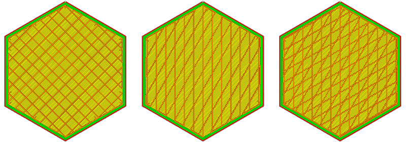

Infill Line Directions
Infill patterns have predetermined line angles. For example, with square patterns such as Lines, ZigZag, or Grid, the infill lines print at a 45° angle. At this angle, both the X and Y motors work together to obtain maximum acceleration and jerk on the layer without losing quality. You can customize the direction of the infill line to increase strength, optimize acceleration, or for visual effects.
To change the direction, enter your desired value(s) between the brackets. If you want multiple angles, separate them with a comma. For example: [0,45]. The angles will be alternated per layer.
Tip: When selecting angles for your line directions, note that 0° is parallel with the Y axis and 90° is parellel with the X axis.
Image above: This example shows ZigZag infill. The model on the left has default values. The middle one has custom values [0,30]. For the right model, a third angle was added: [0,30,60].

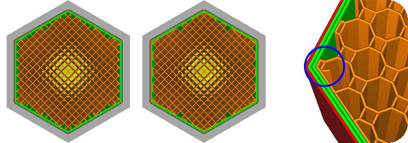

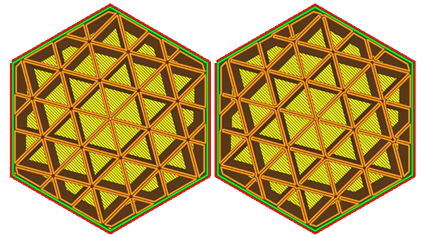

Infill XY Offset
Infill patterns are normally centered for each 3D model. You can apply an offset for the X and/or Y direction to control where the infill will be placed. Especially for lower infill densities, this setting can be useful to position infill lines exactly where they are needed. As seen above, a positive value moves the infill pattern UP and RIGHT, while a negative value moves it DOWN or LEFT.
Image above: The models above have Triangle infill. For the model on the left, the XY offset is default, and the pattern is centered. The model on the right has a 5 mm offset in both X and Y; you can see that the pattern has shifted to the right and up.
Note: This does not work for all infill types. Certain patterns, such as Honeycomb and Octagon, have a predetermined layout on the build plate. Other patterns, such as Concentric and Cubic Subdivision, will always work towards the model center. The setting will not be visible for incompatible infill patterns.

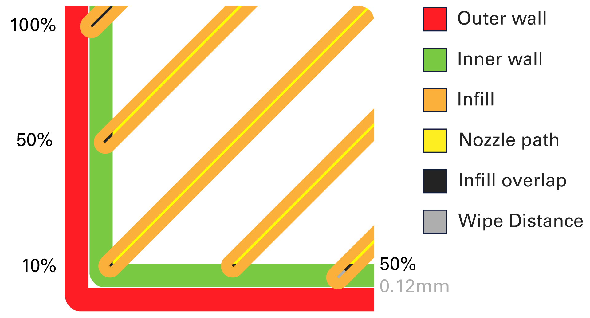

Infill Overlap
With this setting, you can control the amount of overlap between the infill and walls. It can be set as a percentage (of the line width of the infill) or as a value in mm, and it affects the overlap between the infill lines and the innermost wall.
A higher value usually results in better bonding between the infill and walls, making the part stronger. However, it might also reduce the visual quality of the print, because the infill could show through the outer walls. This results in a pattern on the outer surface of the print.
Image above: A visualization of the infill overlap and wipe distance.
Infill Wipe Distance
This setting will make the nozzle move a little bit further than the end of the infill line with a small travel move. The aim of this small travel move is to wipe off the material onto the wall next to it. This fuses the infill line to the wall better. See the image above for a visualization.
While this travel move makes the object stronger, the main disadvantage is that this travel move goes through the wall, which leaves a visible mark on the outside of the print. This strengthens the effect of the infill being visible on the outer surface of the objects.
Note: This setting only applies to the ends of the infill lines. When using connected infill lines, there will be much fewer ends.

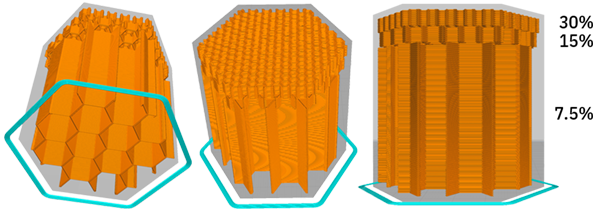

Infill Layer Thickness
Since the layer height of the infill is not important for visual quality, you can use thicker layers on the infill to reduce the print time. This setting causes layers of infill to be combined together, as long as there are multiple layers of infill directly above each other. It will then not print any infill on some of the layers, but in the highest of the combined layers it will extrude more material to make up for it. For example, when your layer height is 0.1 mm and the infill is 0.2 mm, the printer will first print two layers of walls (and skin and/or supports, if applicable), and then it will print one thicker infill layer.
In layer view, it will look as if the infill lines have become much wider. When actually printed, the infill lines will drop down further instead of spreading out horizontally.
The Infill Layer Thickness must always be a multiple of the normal layer height. If a different value is selected, Cura will round off to the closest multiple.
Note: If the difference between the Layer Height and Infill Layer Height is too big, this requires a big change in material flow when switching to and from printing the infill. This could cause some under and over-extrusion issues in these places.
Image above: The model on the left has equal layer heights throughout, and the model on the right has an Infill Layer Height of twice the normal Layer Height.

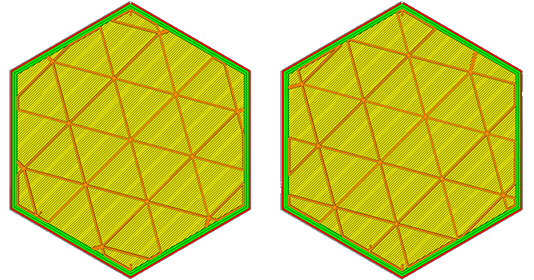

Gradual Infill Steps
Gradual infill reduces the amount of infill used by decreasing the infill density in the lower layers. This saves printing time and material usage, while still offering a dense support below any top surfaces. Note that this will decrease the strength of the infill structure and the object, and should be used for visual models only.
This setting indicates in how many steps the infill density is reduced. At every step, the infill density is halved. For example, starting with an infill percentage of 20% and two gradual infill steps, the infill density of the lower parts will be 10% and 5%, respectively.
Image above: The model on the left has normal infill, and the model on the right uses Gradual Infill Steps.

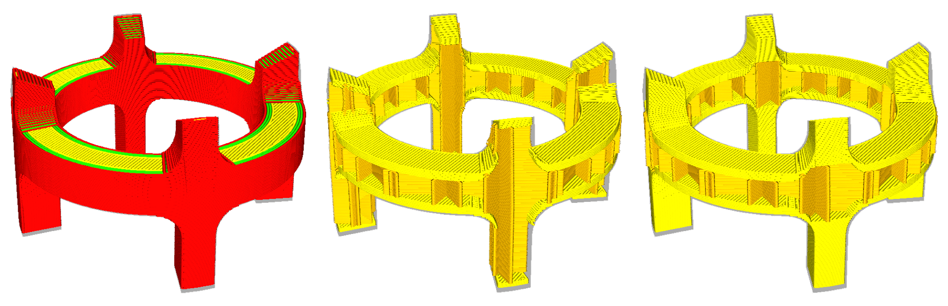

Minimum Infill Area
This setting allows small areas on a single layer to be printed with skin instead of infill, to make them fully solid. This is especially useful on models with thin pieces that require more strength, without increasing the overall infill density or using cutting meshes. An added benefit is that this setting prevents printing very short infill lines, which could cause flow disruptions.
Image above: This coupler has thin pieces. The image in the middle has normal infill (Minimum Infill Area = 0), which leaves some open areas. The image on the right uses a Minimum Infill Area to strengthen the legs of this coupler by filling them completely with skin.

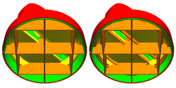

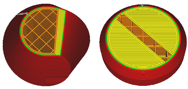

Infill Support
When enabled, this treats infill as support. Infill will then only generate where it is needed in order to support the top surface. It behaves as if the model is hollow and generates support inside it, but this support is generated using the infill settings. See the image below for a visualization.
For some models, this saves a lot of material with little impact on the visual quality. However, the strength of the object is greatly reduced. Especially if there are steep slopes in the model, there will often be no infill behind the walls. This setting should be used for visual models only.
Infill Overhang Angle
If Infill Support is enabled, you can set an overhang angle, similar to the support overhang settings. This setting is not visible if infill support is disabled.
This determines the minimum overhang angle of the surface that needs to be supported with infill. Increasing this angle will cause the infill to support less of the top surface. This saves on printing time and material, but will cause the top skin to sag a bit more.
  • A value of 0° will act like normal infill. It supports everything.
  • A value of 90° will remove all infill material.
Image above: This shows the differences between infill support settings. The model on the left has Infill Support disabled; the entire object is full of infill. The model in the middle has Infill Support enabled with a low/medium setting for Infill Overhang Angle; only the very steep angles are not supported with infill. The model on the right has a high value for Infill Overhang Angle; only the almost horizontal surfaces are supported with infill.

Image above: The model on the left has non-connecting Lines infill, with many start/end inwards moves. The second model uses ZigZag (connected lines), which only has two inward moves per layer. The example on the right shows an inwards move of 1.2 mm using the Octagon pattern.
