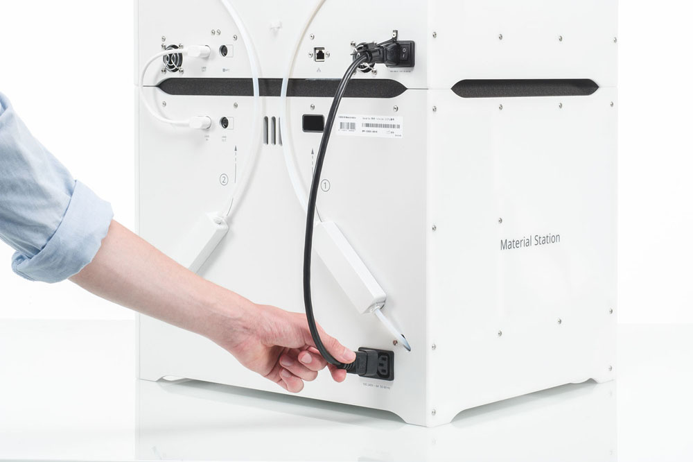

  1. Remove the power extension cable between the UltiMaker S5 and the Material Station.

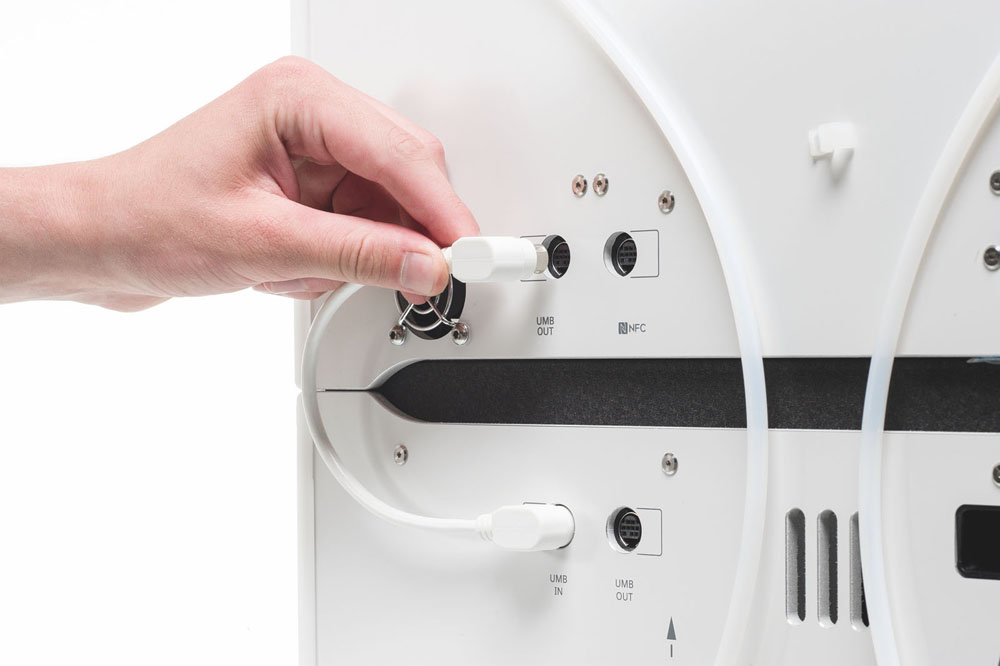

  2. Remove the communication cable from the UMB ports on the UltiMaker S5 and Material Station.

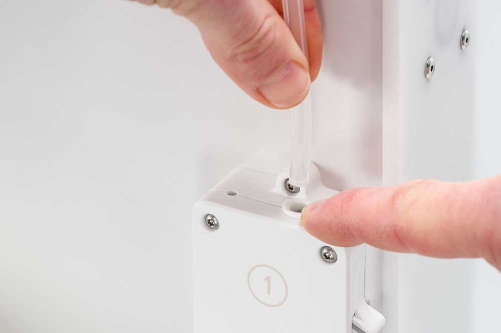

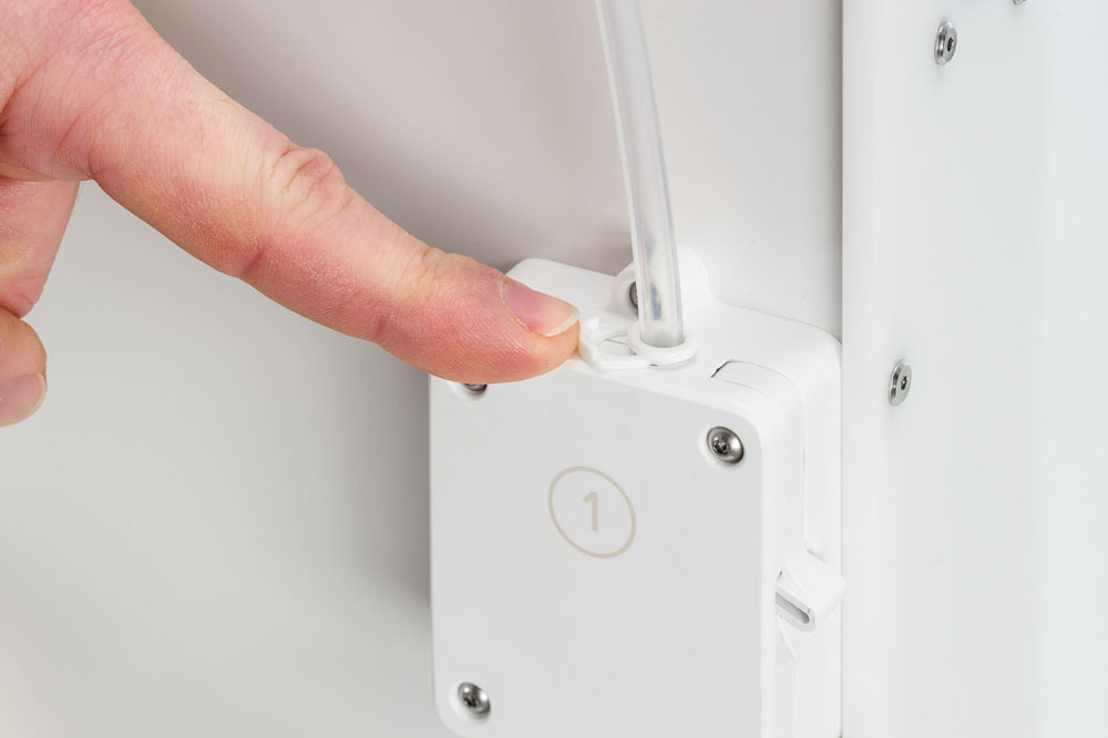

  3. Remove the clamp clips and the Material Station's Bowden tubes from the bottom of the UltiMaker S5 feeders.
  4. Take the tube coupling collets out of the bottom of the feeders; these will be reused for the new feeder assemblies.

Disconnect the UMB cable

  1. Remove the clamp clips and disconnect the Bowden tubes from the top of the Ultimaker S5 feeders.

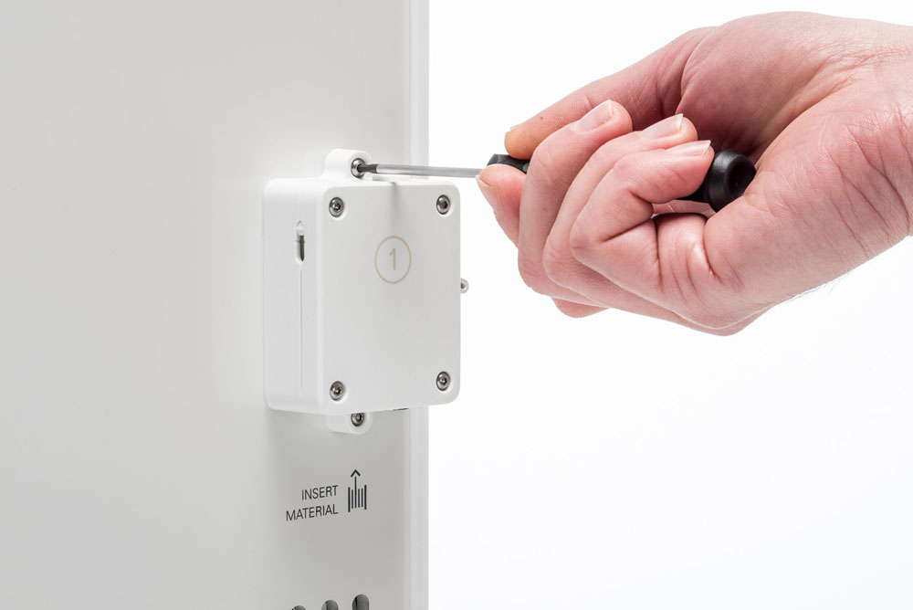

  2. Loosen and remove the two bolts that secure each feeder to the back panel.

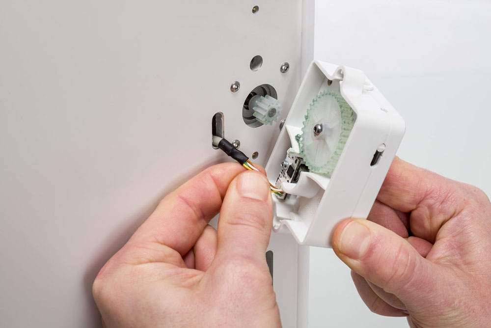

  3. Carefully move the feeder away from the back panel and disconnect the filament detection cable from the flow sensor.
Tip: While the feeder is removed, clean the feeder gear and apply some new grease to the gear. This ensures a smooth operation of the feeder.

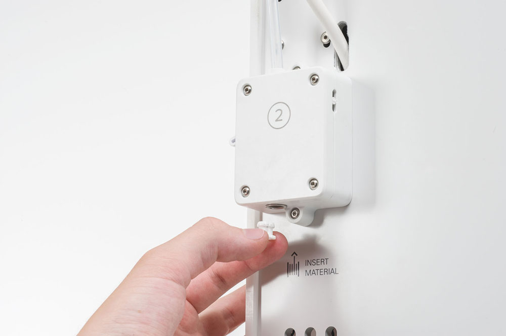

  4. Insert the tube coupling collets (which came from the old feeders) in the feeder ring at the bottom of the new feeders.
  5. Push the Material Station's Bowden tubes into the corresponding UltiMaker S5 feeders and secure each with a clamp clip.
