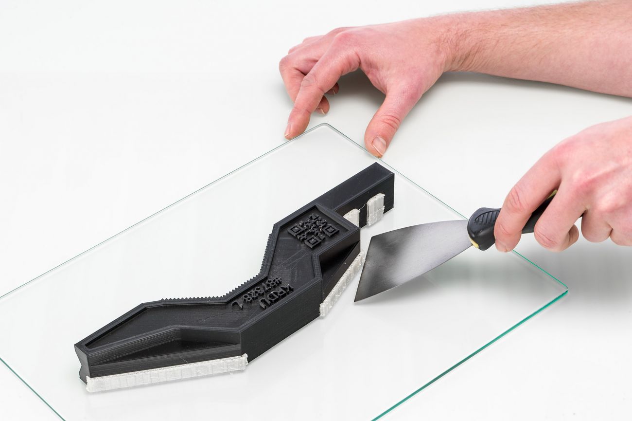

Use a spatula
If your print is still adhered to the build plate after cooling, you can use a spatula to remove the print.
Caution: Never do this inside the printer. Always take the build plate out of the printer to avoid damaging the build plate clamps.
Place the glass build plate on a flat surface. Place the spatula under the print, keep it parallel to the build plate, and apply a small amount of force to remove the print. A spatula can also be used to carefully remove the remaining parts of the print from the build plate, such as the brim or support structures.
Caution: The edges of the model or brim can be sharp. Wear protective gloves to prevent injury. Be aware of the risk of glass chipping, especially for high-temperature materials or if the correct adhesion method was not used. Safety glasses are advised.
