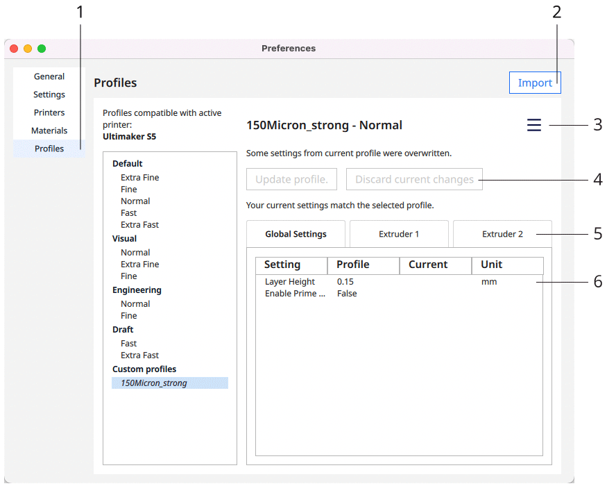

Managing your profiles can be done in the Profiles tab of the Preferences menu. You can access this overview in three different ways:
  • Use the keyboard shortcut CTRL+J on Windows or ⌘+J on Mac
  • In the top bar, click Preferences → Configure Cura... and then select the Profiles tab
  • Open the print profile quick menu and select Manage Profiles...
Tip: A lot of print profile manager functionality can also be found in the print profile quick menu.
The print profile manager contains all default and user-saved profiles and allows you to manage these in a convenient way.
  1. Profiles. The profile tab in the UltiMaker Cura Preferences panel.
  2. Import. Allows importing previously exported print profiles into UltiMaker Cura.
  3. Menu. Activate, duplicate, remove, or rename the selected profile. Some options could be grayed out. You cannot remove or rename preset profiles or currently active custom profiles.
  4. Update profile. Update the profile or discard any unsaved changes made to the custom profile. If you update a preset profile with changed settings, this will create a new custom profile.
  5. Extruder tabs. Print profile information is stored in the global settings tab that counts for both extruders. The separate extruder tabs contain extruder unique parameters.
  6. Profile values. All changes made to the printing profile compared to the default profile. Changes are displayed per extruder.
