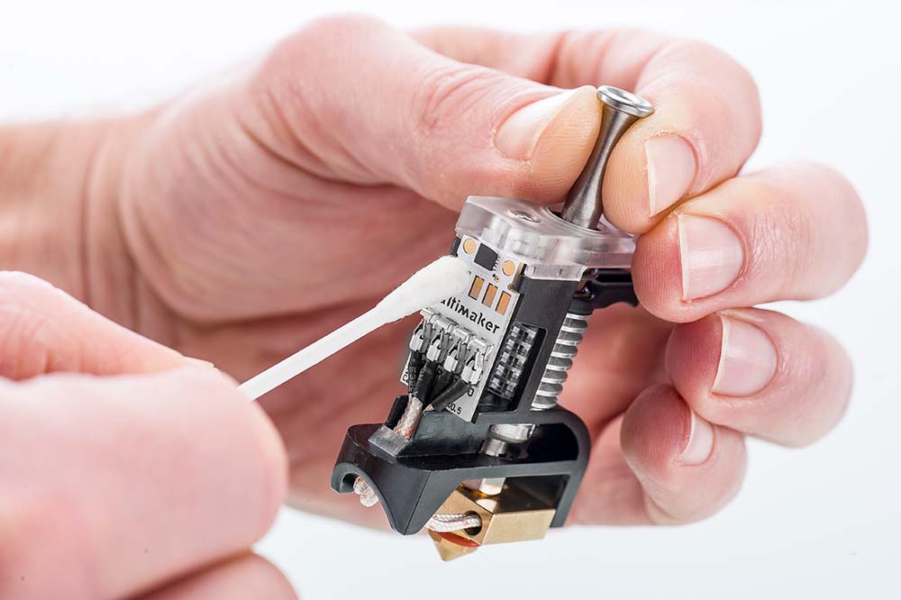

Clean the connections
If the error continues to appear even when the print core is installed securely in the print head, the contact points may need to be cleaned. Dust or grease on the print core or PCB may be interrupting the connection.
Note: Never touch the contact points at the back of the print core with your bare hands, as oils and grease can affect the connection.
Remove the print core from the print head. Carefully clean the contact points at the back of the print core with a cotton swab and some (isopropyl) alcohol.
Caution: Isopropyl alcohol (CAS nr. 67-63-0) is a hazardous, highly flammable substance. Keep away from heat, sparks, static discharge, and other potential ignition sources. Ensure good ventilation and avoid inhaling the vapor. Read the SDS from your IPA supplier to learn more about the risks and safety precautions or find more information here: Isopropyl alcohol (IPA) safety.

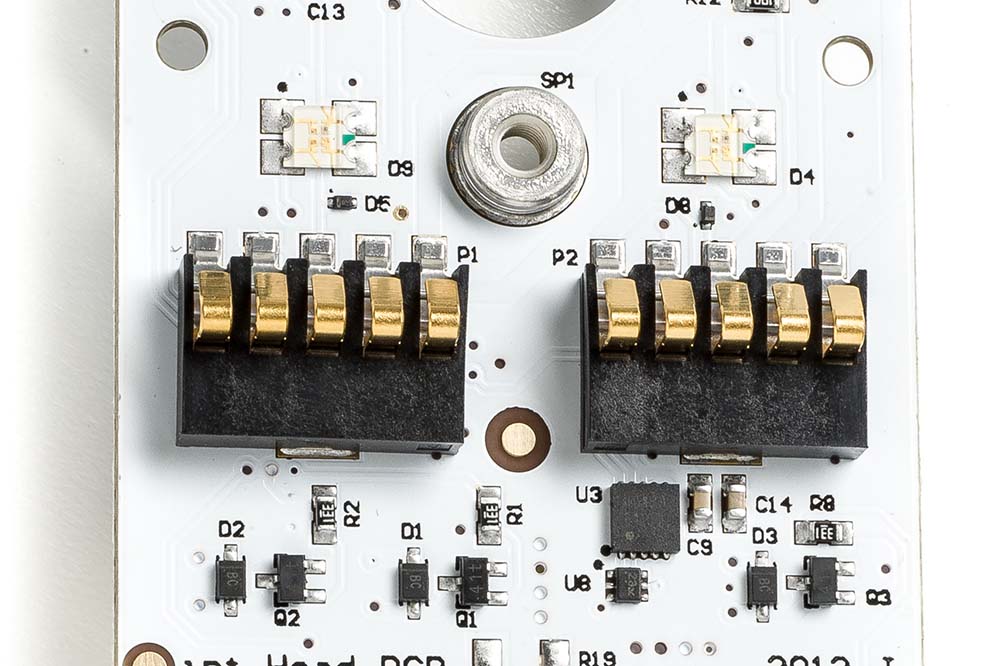

Also check the pins of the PCB inside the print head. You can also clean these with a cotton swab and some (isopropyl) alcohol. Ensure to only gently brush upwards, to prevent the risk of bending the pins. Turn off the printer before cleaning the print head PCB pins.
Clean the print core contacts
The print head PCB pins

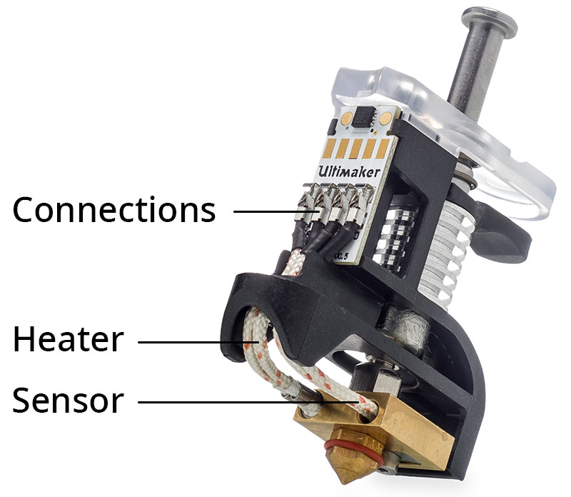

Check the print cores
If the tips above have not helped to resolve the error, there could be a problem with the heater and/or sensor of the print core. If these are damaged or disconnected, the printer will show the max temp error as a safety measure and prevent the print core from heating up.
At the back of the print core, closely inspect the heater and sensor wires. The temperature sensor is inserted into the smaller hole on the right (as seen from the back) and the heater is the one on the left (as seen from the back) with the metal sleeve.
  • Ensure that both the heater and sensor are still fully inserted into the print core heater block.
  • Check that none of the wires look frayed or display any signs of damage.
  • Also, check that all four of the wires are still correctly connected to the print core PCB at the back.
If you see any signs of damage to the print core, its wires, or the connections, replace the print core.
