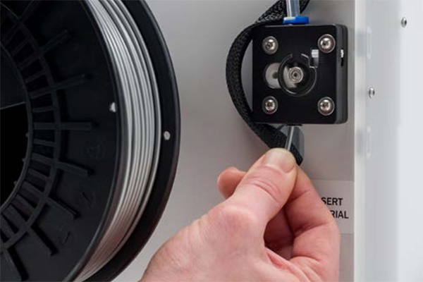

The feeder will start turning slowly. Insert the end of the filament into the bottom of the feeder. Apply pressure until you feel that the feeder grips the material. The filament will now automatically slowly move upwards.

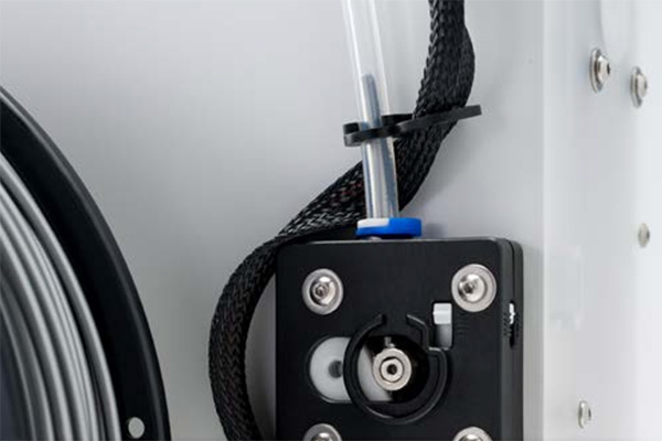

As soon as the filament is visible in the Bowden tube above the feeder, confirm this using the button.
Note: Do not wait too long with pressing the controller button. After this, the printer will automatically forward the filament to the print head. If the material is too far into the Bowden tube, the material will jam in the hot end and the feeder will grind into the filament.
