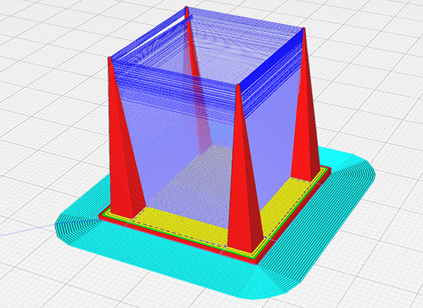

After slicing, you can check the Layer view. Travel lines with retraction are shown in a light purple / lavender color, while unretracted travel lines are represented in a rich blue.
Tip: Even if retraction is enabled, not all travel moves may be retracted! This is due to other settings affecting whether or not to retract. Learn more about the Cura settings in the Travel section in this article.
