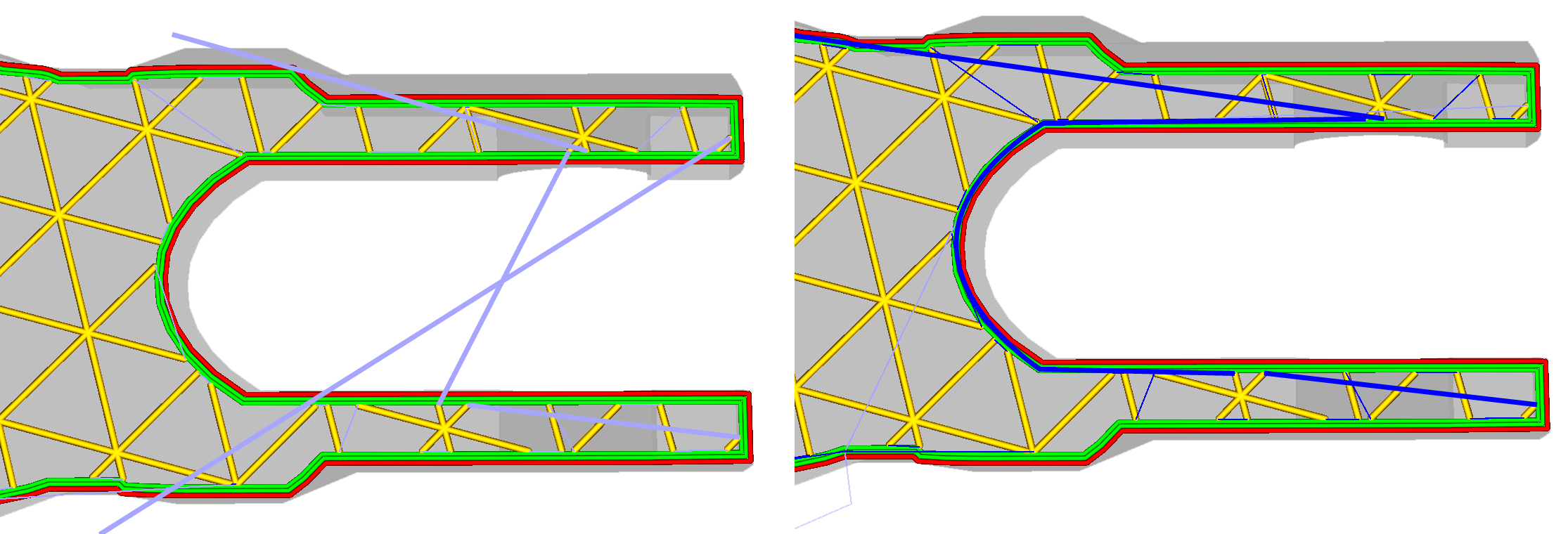

Combing Mode
Combing will reduce the chance of defects on outer surfaces of the print by recalculating all nozzle travel moves to stay within the perimeter of the print. This results in greater travel distances, but with a reduced need for material retraction.
If combing is disabled, the material will retract and the print head will move in a straight line to the next point.
Combing.pngCombing disabled (left) has retracted travel moves that move outside the print’s boundaries. Combing enabled (right) has unretracted travel moves within the print’s boundaries.

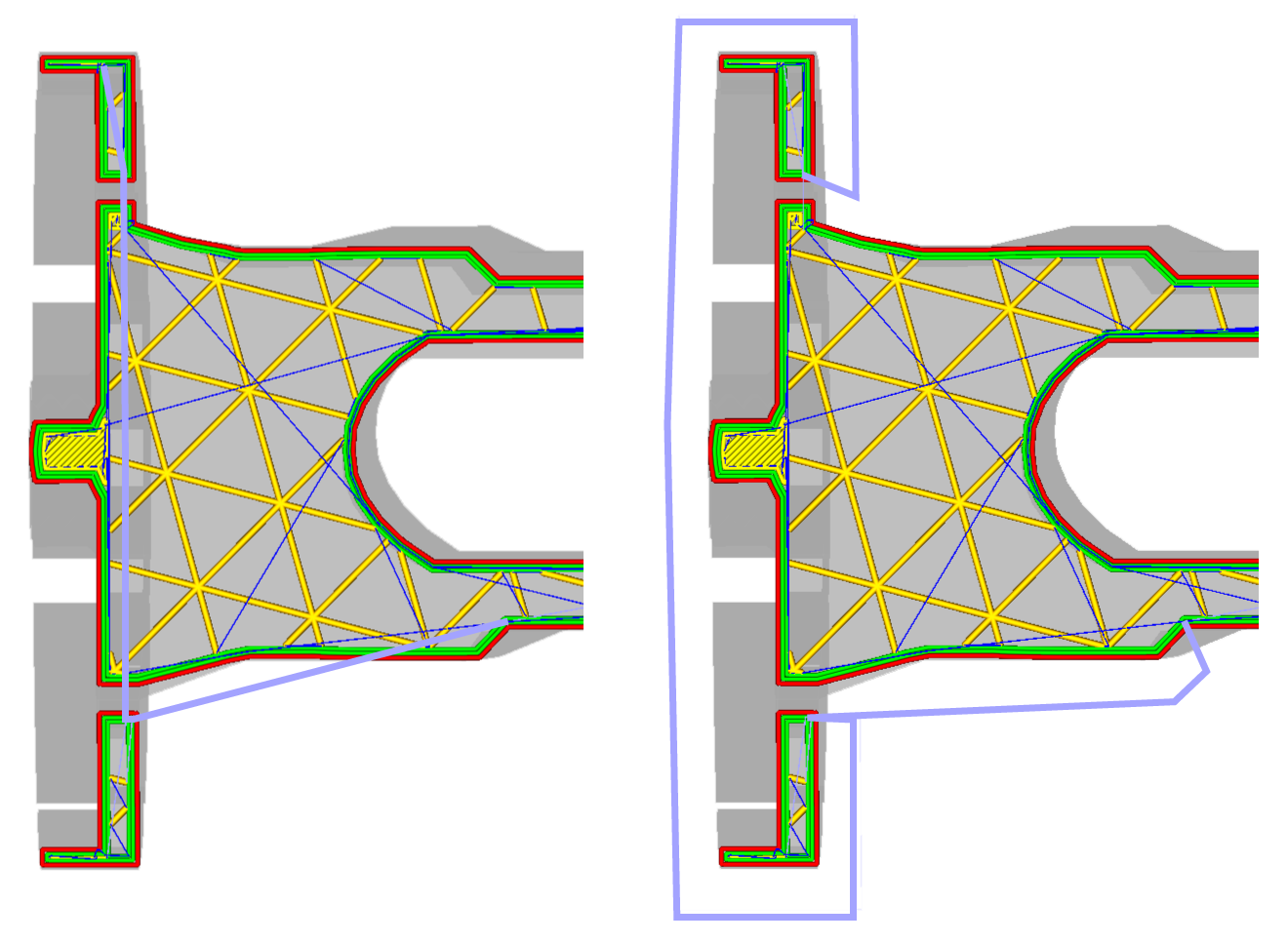

Avoid printed parts
By enabling this setting, the print head will avoid printed parts when traveling. When the shortest route from one point to another in the print is obstructed, the print head will move around it. This decreases the possibility of coming into contact with parts of the model that have already been printed, in turn reducing the chance of surface defects or material mixing. To use this setting, you must first enable combing.
AvoidParts.pngThe travel moves in both images start and end at the exact same location. Avoid printed parts is disabled for the model on the left, and enabled for the model on the right.
