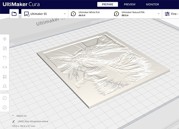

Convert image

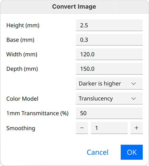

When you are finished editing your picture, load it into Cura. A popup window will appear to convert the image for 3D printing. Here, you can adjust a number of settings as necessary:
  • Height. This is the total height of the print minus the base. A higher value will create more detail, but will also reduce the transparency of your print. If you want to retain some transparency in the thicker parts of the print, a height of 2 - 3 mm is recommended.
  • Base. The base height from the build plate. These layers will be fully solid. It is recommended to have at least 1 - 2 solid layers, but too many base layers will reduce the contrast and transparency. The Cura setting Initial Layer Height affects the number of base layers.
  • Width and depth. The total X and Y dimensions of the print. Changing either value will affect the other; the model is always scaled uniformly in this popup window. You can also scale the model later using the Adjustment tools but note that this can reduce the quality.
  • Lighter / darker is higher. This setting determines which parts of the print will be thicker. For lithophanes, use Darker is higher. Dark pixels correspond to thicker locations to block more light from coming through.
  • Color model. Choose between Translucency or Linear. For lithophanes, a simple logarithmic model for translucency is available.
  • 1 mm transmittance. This setting influences the percentage of light penetrating a print with a thickness of 1 mm. Lowering this value increases the contrast in dark regions and decreases the contrast in light regions of the image.
  • Smoothing. Choose a value between 0 and 100. Higher values create smoother edges but will reduce the contrast and potentially the accuracy of the print.
When you are satisfied, click OK to convert the image.

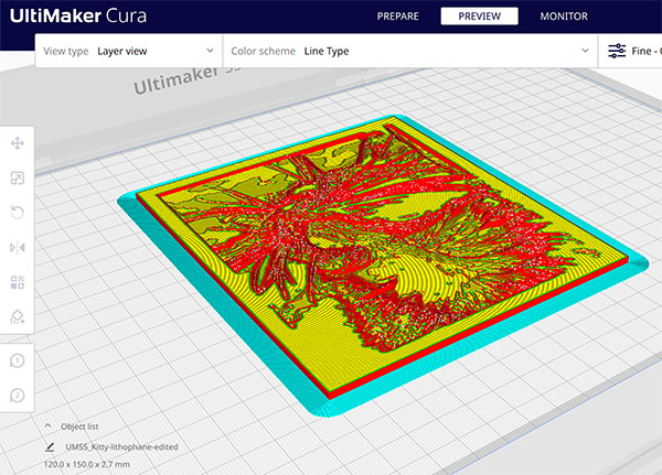

  • Infill or top/bottom. For the lithophane effect to work, it is important that your print is made solid and does not contain any infill patterns. Either set your infill to 100% (this will automatically change the infill pattern to one that supports solid fill, such as zigzag) or set the top/bottom thickness to at least half the print height.
  • Speed. Slower print speeds prevent under-extrusion and give better results, but the travel speed should be higher to prevent oozing.
  • Build plate adhesion. To ensure a reliable adhesion to the build plate and to prevent warping, using a brim is strongly recommended.
When you have finished slicing, always check the slicing result in the Preview mode. In the layer view, you can ensure that (at least) the first layer is solid and that no infill patterns are generated.
