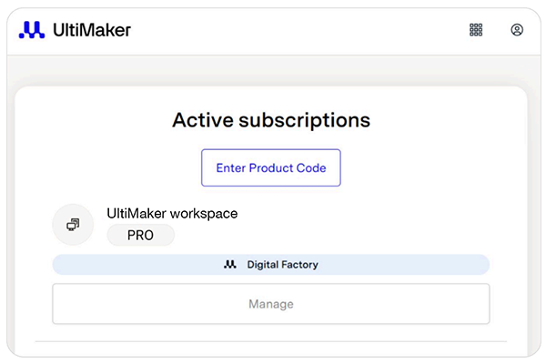

  1. Go to subscription.ultimaker.com.
  2. Log in with your existing UltiMaker account, or create a new one.
  3. In the Active subscriptions section, click the Enter Product Code button.
  4. In the pop-up window, enter your TRACE activation code and click Continue.

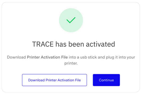

  1. Confirm your printer and product details, and click Activate Product.
  2. Click Download Printer Activation File and save it to a USB drive.
  3. Insert the USB drive into your Factor Series printer.

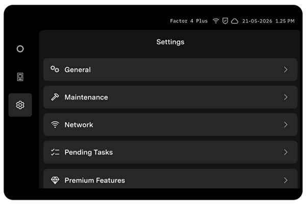

  4. In the Options menu (gear icon), go to Settings → Premium Features and tap Unlock Feature.
  5. Select the file from the USB drive.

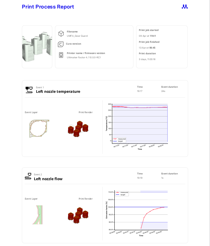

A TRACE contains a number of elements. At the top of the page, the metadata on the print job can be found. Below that can be any number of events. In case there are no events, everything in the print process went as expected. If there are print process events where control loops went outside the bounds, these contain 4 components:
  • Metadata on the event (When did it happen? What type of control loop? How long was the event?)
  • A top-down image showing where in the print job the event occurred
  • A 3D image showing where in the print job the event occurred
  • A graph showing the data around the event
Tip: See an example of a TRACE report with a few events below:

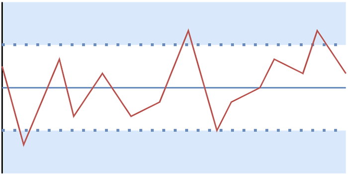

Noisy
  • Extrusion factor: Very challenging print profile settings can make the extrusion factor unstable. This should not happen when using the default UltiMaker profiles.
  • Nozzle temperature: A bad connection between the print core and print head (a physically damaged print core can introduce noise).
  • Build volume temperature: A bad connection between the build volume temperature sensors and the rest of the printer.
  • Build plate temperature: A connection issue in the build plate heater can cause a noisy signal.
Note: In case of noisy data in the TRACE report, please contact support. The printer may need service or maintenance.

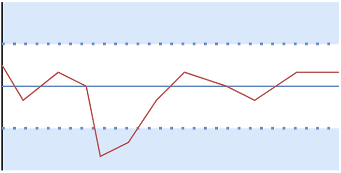

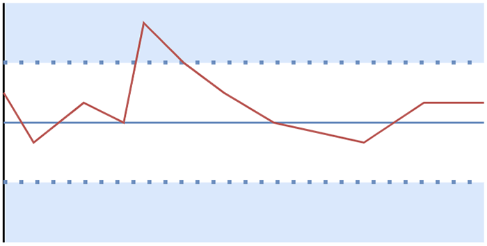

Peak
  • Extrusion factor: A temporary blockage at the nozzle either by the print being too close or by a clog in the nozzle can cause a downward peak.
  • Nozzle temperature: Nozzle overshoots or undershoots during nozzle switching can lead to a peak in temperature.
  • Build volume temperature: If the door sensor detection is turned off this can cause a downward peak in temperature when opening the door during the print. Blocking the filter fan airflow for a short time (for example by placing something on top of the exhaust) can cause an upward peak.
  • Build plate temperature: A connection issue in the build plate heater can cause an upward or downward peak.

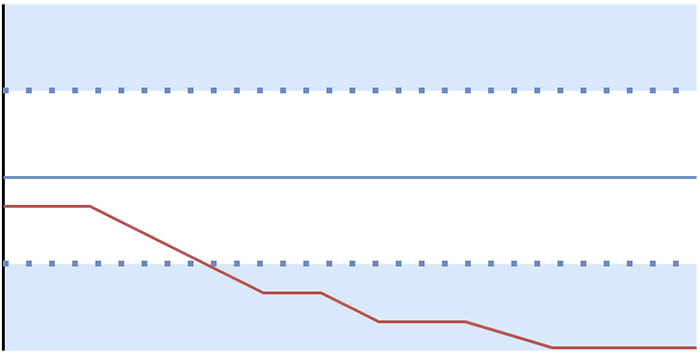

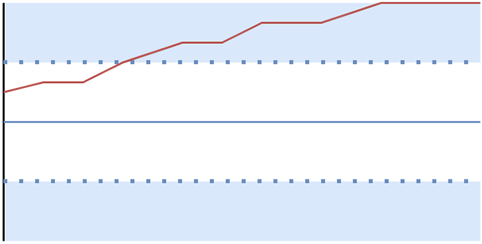

Drift
  • Extrusion factor: A drift downwards could mean the nozzle is slowly getting blocked. Either by a clog or the print itself. Material jamming/buckling in the extruder could lead to a downward drift.
  • Nozzle temperature: The nozzle temperature can drift down when the nozzle is no longer insulated by the silicone nozzle cover.
  • Build volume temperature: Blocking the filter fan airflow (for example by placing something on top of the exhaust) can cause an upward drift. Operating the printer outside of the specified ambient operating conditions can also lead to drifts.

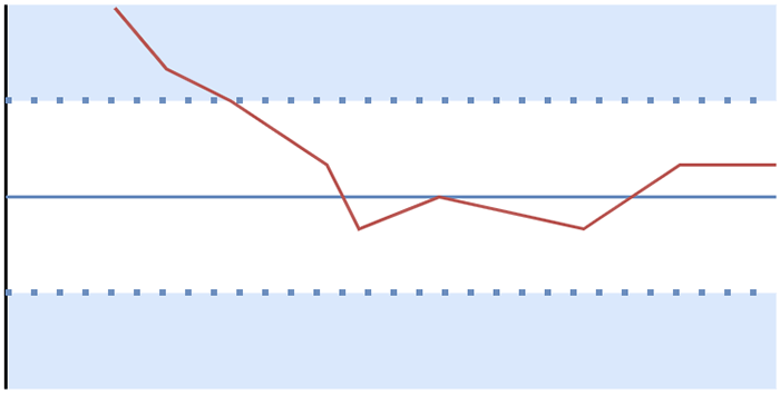

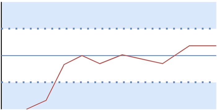

Settle
  • Extrusion factor: Loading material can cause the extrusion factor to be off due to being out of range during purging.
  • Nozzle temperature: Nozzle overshoots or undershoots during nozzle switching can lead to an error when starting with printing
  • Build volume temperature: With the door sensor detection disabled: Resuming a print after the door has been opened during pausing can cause the temperature to be too low.

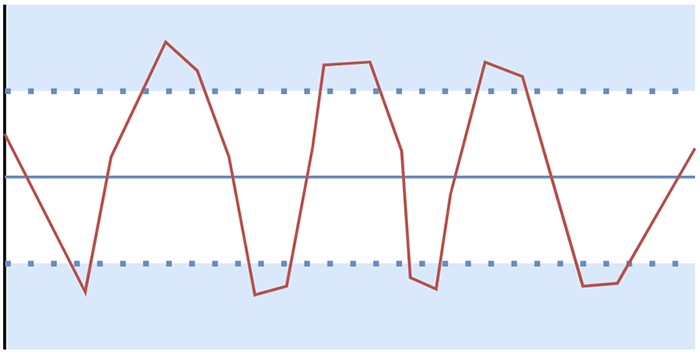

  • Extrusion factor: A warped print can cause these types of oscillations.
  • Nozzle temperature: Very short layer times and bad thermal behavior (such as a damaged or missing nozzle cover) can lead to oscillations.
