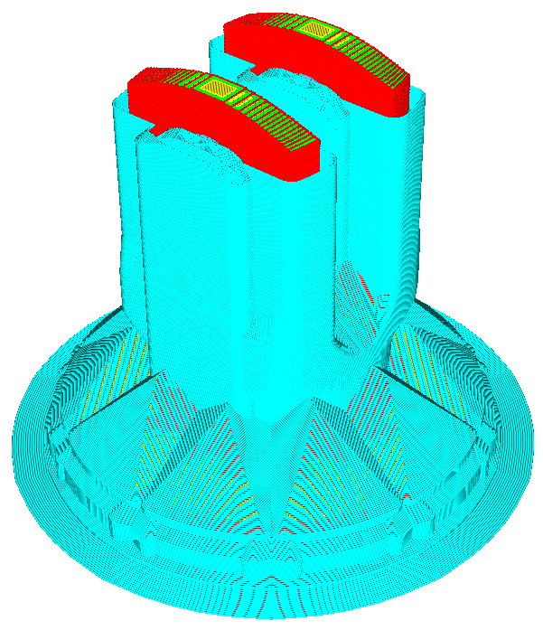

Enable ooze shield
The ooze shield is a separately printed, one-layer wide wall around the object, which catches ooze from incoming nozzles before each layer is printed. The ooze shield will print with each extruder, alternating every layer. The maximum height of the ooze shield is the last layer which includes an extruder switch.
It has two separate settings that can be controlled:
  • Ooze shield angle. The maximum angle of the ooze shield. This is to prevent the shield from collapsing.
  • Ooze shield distance. The distance between the ooze shield and the model. This is used to prevent the shield from merging with the model or making it too difficult to remove after printing.
This model is printed with the ooze shield enabled. The ooze shield needs to be removed after the print finishes, revealing the underlying model.
