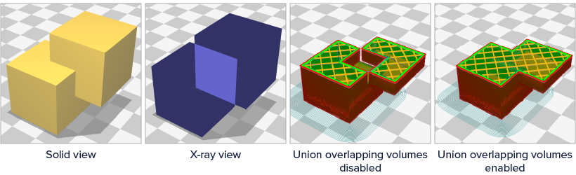

Union overlapping volumes
If a model contains two volumes that interfere (as if they were placed through each other), this setting allows you to fix that. Union overlapping volumes will recognize these interferences and try to slice it as one volume.
Union-overlapping-volumes.pngThese two cubes overlap and produce invalid geometry by default. From left to right: solid view, x-ray view, “Union overlapping volumes” disabled, and with “Union overlapping volumes” enabled

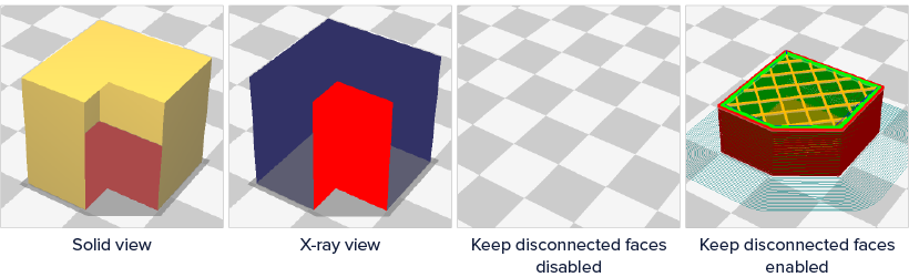

Keep disconnected faces
Models that contain holes on corners are ignored by Ultimaker Cura. It’s impossible to know how the missing geometry should look. With this option enabled, Ultimaker Cura connects all neighbouring geometry to close the model.
This model is missing geometry that connects to multiple neighbouring polygons. Without knowing this should be a cube, Ultimaker Cura cannot connect the faces, and therefore produces nothing. From left to right: solid model, x-ray view, and “Keep disconnected faces” enabled
