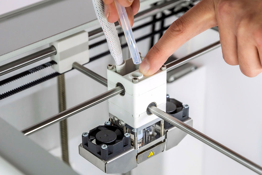

  1. Place the print head in the front-right corner.
  2. Remove the clamp clips from the tube coupling collet at the print head.
  3. Press down on the tube coupling collet in the print head and at the same time, pull the Bowden tube upwards, out of the print head.
  4. Loosen the five cable clips from the Bowden tube to completely remove the tube.

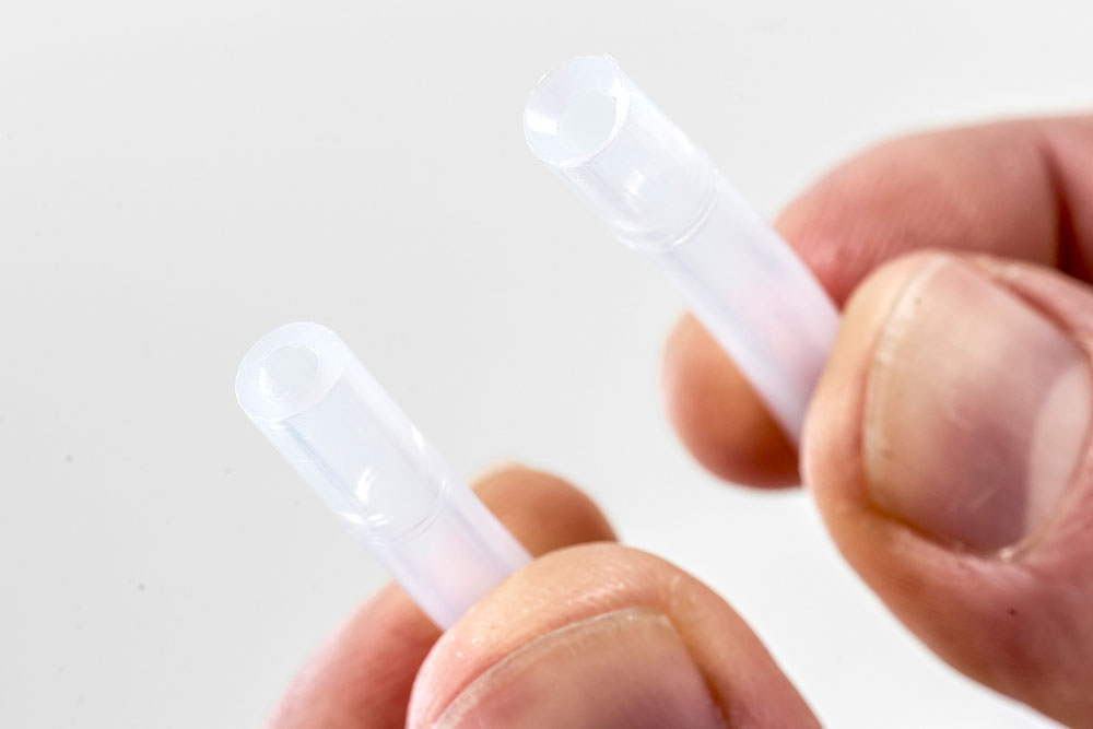

  1. Take the new Bowden tube and note the two sides. One end is marked with a thin line, which indicates how far the tube should be inserted into the print head.
Note: If your Bowden tube is not marked, check the chamfers on the tube ends. If only one side is chamfered, insert this side into the feeder. This makes it easier for the filament to enter the Bowden tube.

  1. Insert the Bowden tube into the print head by pressing down on the tube coupling collet in the print head and pushing the Bowden tube all the way in.
  2. Pull the Bowden tube and tube coupling collet approximately 2 mm upwards. Keep the tube coupling collet up and push the Bowden tube further in.
  3. Secure the tube with the clamp clip.
