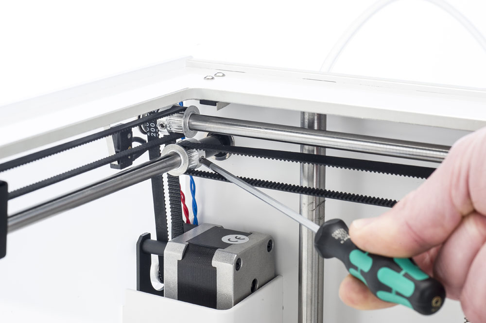

Loosen all the pulleys. Use the hex screwdriver to loosen the screws on all the pulleys that hold together the axles. There are 9 in total.

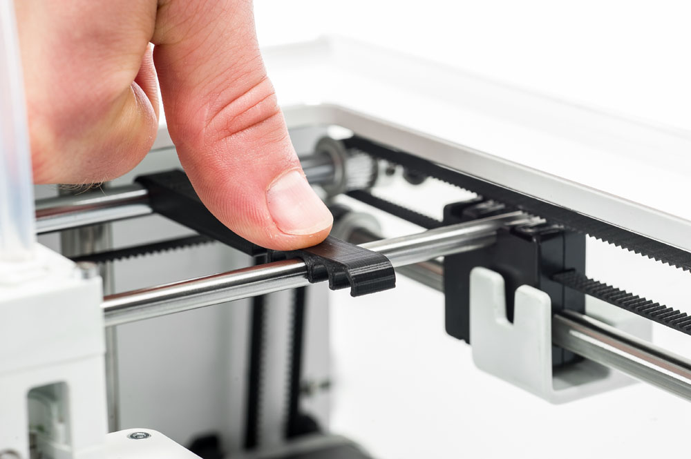

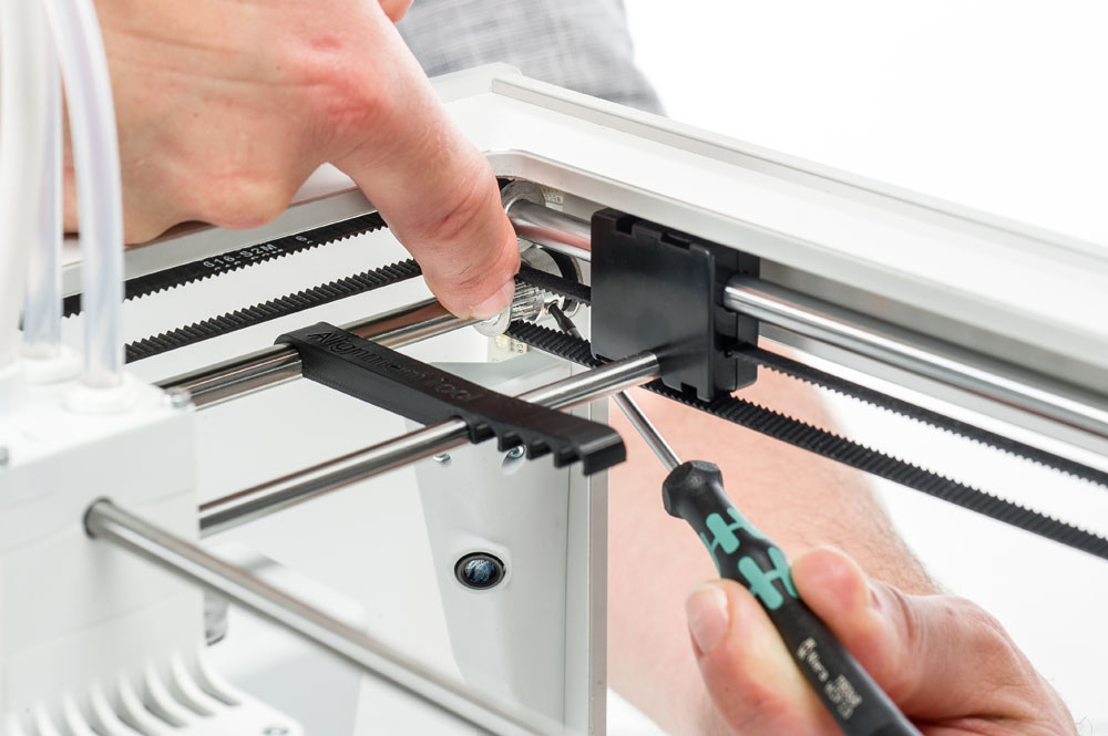

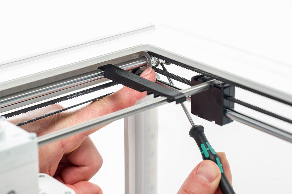

Use the calibration sticks on the back X axle. Place the print head in the middle of the printer and place the calibration sticks around the back X axle, one on each side.
  • Move the print head to the back until the set screw of the back right pulley is visible
  • Click the print head calibration sticks around the print head shaft and make sure that it falls into the same notch
  • Push the back right pulley towards the frame and fully tighten the set screw in the pulley (0.5 Nm recommended)

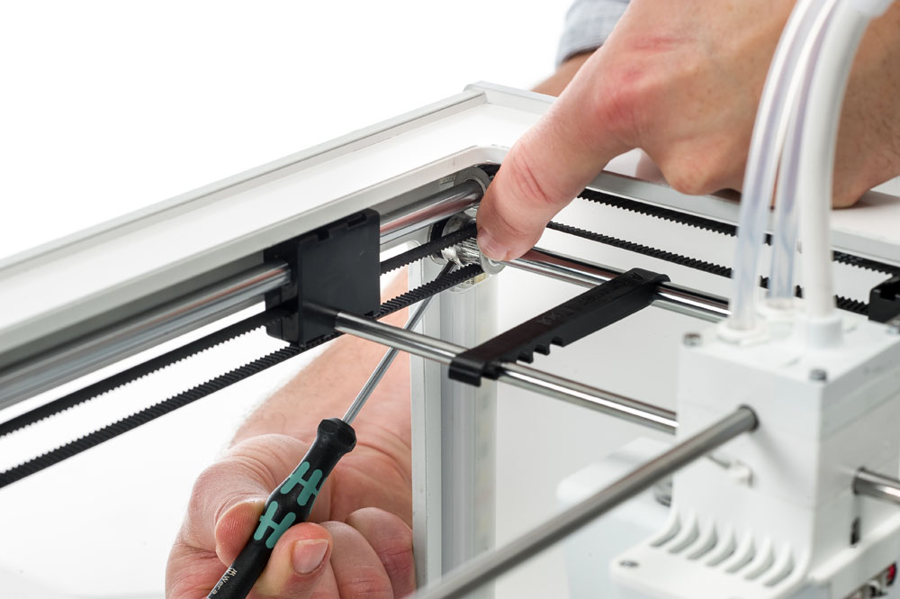

Use the calibration sticks on front X axle. Remove the calibration sticks from the back X axle and place them on each side of the front X axle.
  • Move the print head to the front until the set screw of the front left pulley is visible
  • Push the front left pulley towards the frame and fully tighten the set screw in the pulley (0.5 Nm recommended)

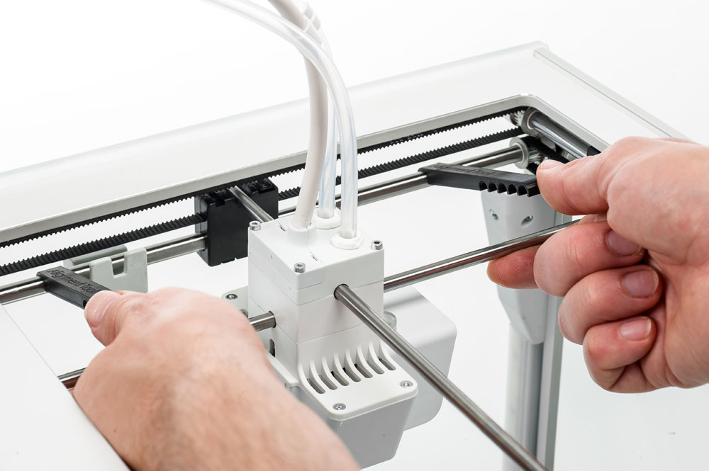

Use the calibration sticks - right Y axle. Remove the calibration sticks from the front X axle and place them on each side of the right Y axle
  • Move the print head to the right until the set screw of the front right pulley is visible
  • Push the front right pulley towards the frame and fully tighten the set screw in the pulley (0.5 Nm recommended)

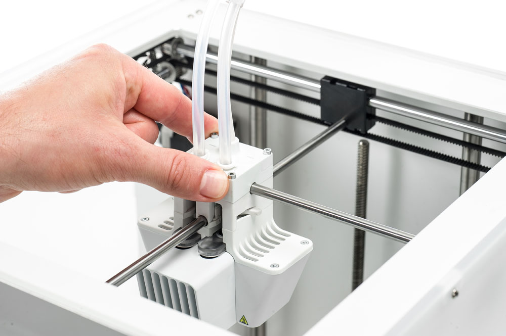

Check the print head movement. Remove the calibration sticks and place the print head in the front left corner.
  • Move the print head diagonally towards the back right corner
  • Now move the print head diagonally from the back left to the front right corner
If the movement is smooth, the calibration was successful. If not, repeat the procedure.
