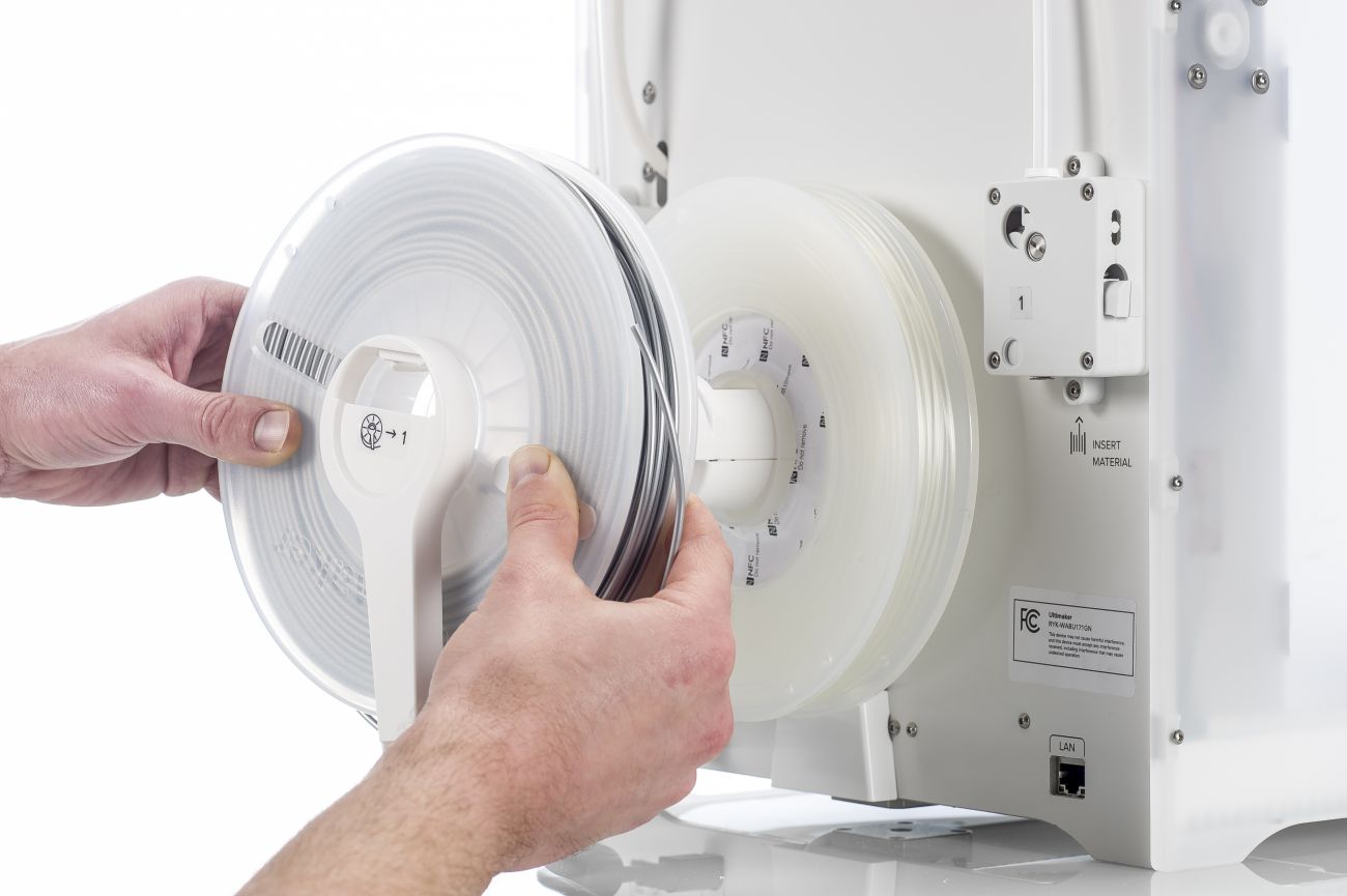

Install the new spool
Place the new material on the spool holder and wait until the Ultimaker 3 detects it. If using a non-Ultimaker material, select the material type in the menu manually.
Tip: When changing material 1, place the spool on the filament guide. When changing material 2, don't forget to place the filament guide with material 1 back onto the spool holder.

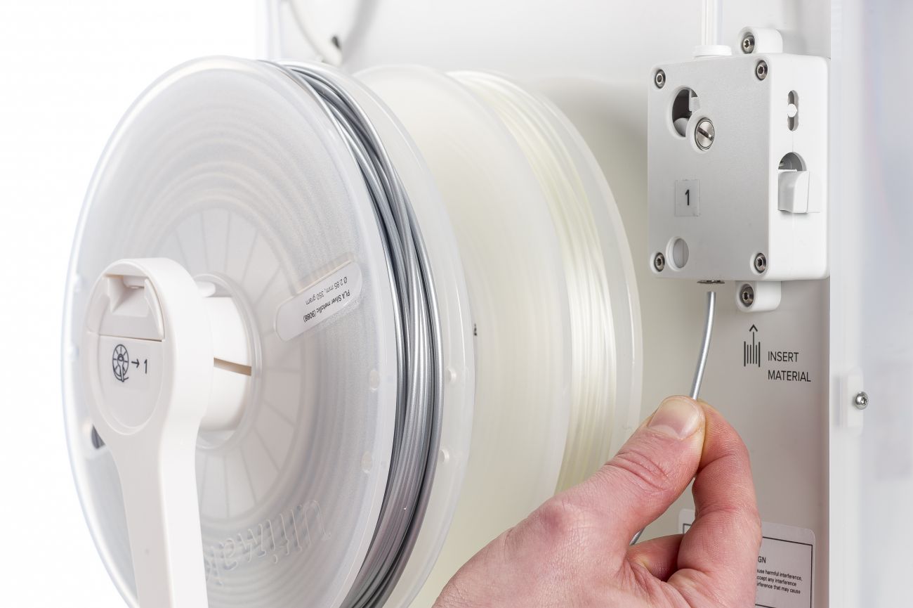

Load material
Insert the end of the filament into the feeder until the feeder grips the material. As soon as the filament is visible in the Bowden tube above the feeder, confirm this using the button.
Note: Don't wait too long to confirm to prevent the material from getting stuck during the loading process.
Extrude material
The filament will now fast-forward to the print head. Wait until it extrudes from the nozzle and any residue from the previous material has been flushed out. Confirm when the new material is flowing consistently and remove the strand of filament from the printer.
