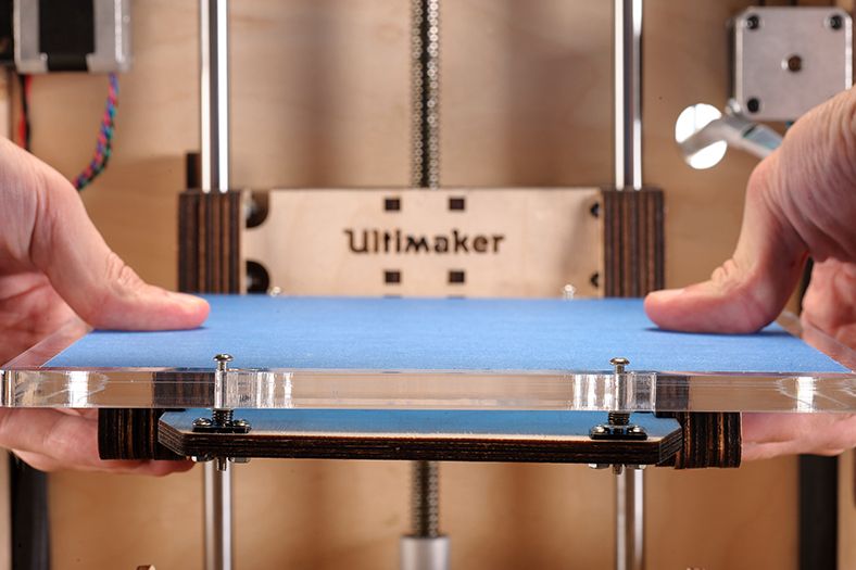

Remove the build platePush down on the acrylic build plate and slide it to the side. You can now remove it from the screws and take it out of the printer.

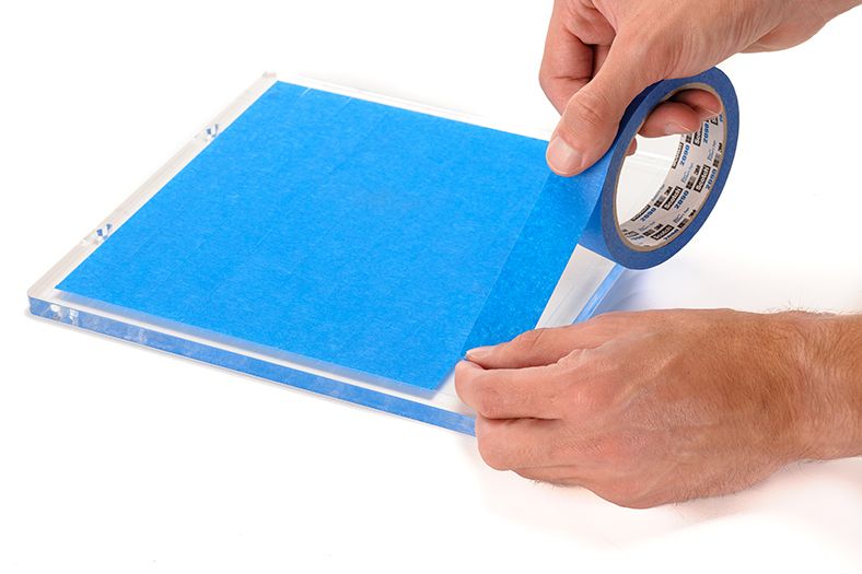

Remove the old tapePeel off the old strokes old the blue tape. If certain strokes are still ok you can leave them in place, but it is recommended to replace the entire layer regularly.
Place the new tapeApply new strokes of blue tape to the build plate. Ensure to place them neatly side by side. Avoid overlaps, and minimize gaps between the strokes.
Reinstall the build platePlace the build plate with the newly applied tape back into the printer. Align it with the screws, push it down, and slide it to the side to lock it in place.

Tip: To ensure good adhesion of your next print, it is recommended to re-level the build plate after repositioning the acrylic plate.
