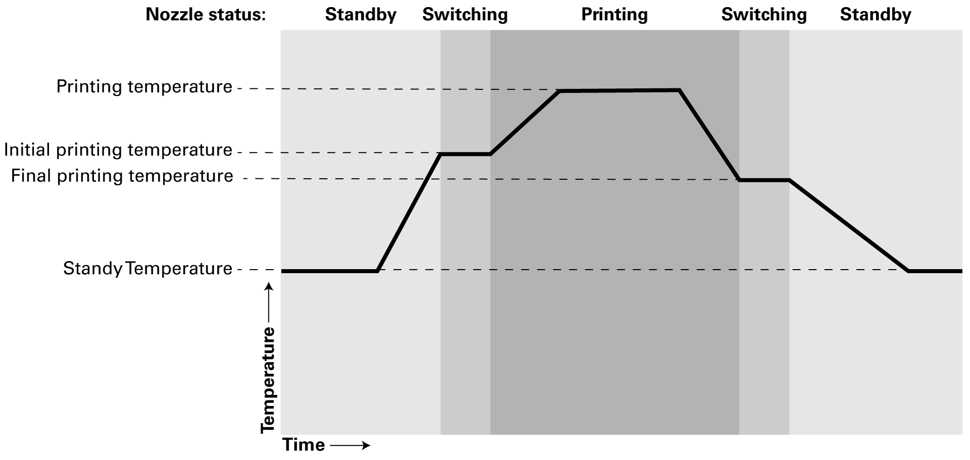

Initial Printing Temperature
This setting is only used in dual extrusion machines. In dual extrusion prints, the active extruder is at the Printing Temperature while the inactive extruder is at the Standby Temperature (set in the material properties). When the extruders switch, one will cool down while the other heats up. As the idle (soon to be active) extruder heats up, it will increase the temperature to the Initial Printing Temperature. This is slightly lower than the Printing Temperature. This speeds up the heating and switching process and reduces oozing during the extruder switch.
Final Printing Temperature
This setting is only used in dual extrusion machines. When switching nozzles, the nozzle that becomes inactive has to cool down. Just before the nozzle switch, the nozzle is allowed to cool down to this temperature while continuing to extrude. It will start cooling down at such a moment that the nozzle is expected to reach the Final Printing Temperature exactly when the extruder switch happens. After that, it will continue cooling down towards the Standby Temperature. This reduces oozing during the switch and when in standby mode.
Image above: This shows the various temperatures in the nozzle before and after extruder switches. From the standby temperature, the nozzle heats to the initial printing temperature just before the switch. During printing, it heats up further to the printing temperature. Just before becoming inactive, it cools down to the final printing temperature, which it has reached during the switch. It will then cool down further to the standby temperature.

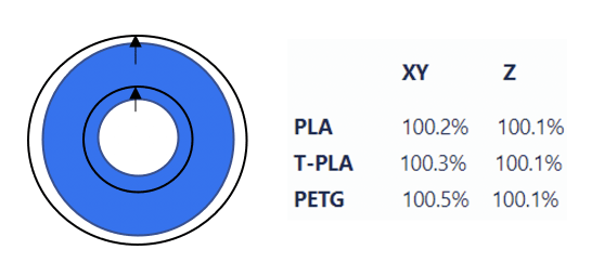

Scaling Factor Shrinkage Compensation
This setting takes into account the dimensions your 3D model will have after printing and cooling of the 3D printed material. This allows dimensions to come even closer to the expected final result. As materials have different shrinkage factors, the values here depend on the material loaded in your 3D printer.
This setting effectively scales the model automatically before slicing. The aim is to compensate for any shrinkage that happens when the print cools down to room temperature. By making the print slightly bigger than desirable, the final result could be more accurate to the original dimensions of the input model. This scaling factor is applied equally to all dimensions (X, Y, and Z).
A factor of 100% will not cause any scaling. A scaling factor of slightly more than 100% is appropriate for many materials, such as PLA or PETG. A scaling factor of less than 100% prints the model smaller than its actual dimensions, which would increase shrinkage.
Tip: Cura will indicate the scaling factor around the footprint of the model. This helps to prevent placing objects too close to each other, to the prime tower, or to the edge of the available build plate area.
This setting has two sub-options:
  • Horizontal Scaling Factor Shrinkage Compensation. This scaling factor is only applied to the X and Y directions. Typically, horizontal shrinkage is greater than vertical shrinkage because the lines are printed horizontally. This means that is where the internal stresses are greater. The horizontal factor can be slightly higher than the vertical scaling factor.
  • Vertical Scaling Factor Shrinkage Compensation. This scaling factor is only applied to the Z direction. The vertical shrinkage is usually a lot less than horizontally because there is less vertical stress. The only shrinkage is of the material itself, which is usually almost negligible.
Image above: This shows an example of scaling factors applied horizontally and vertically for several materials.
Tip: The scaling factor is linked for all extruders. In dual-extrusion prints using different material types, the scaling factor will be set to the average value of the two materials.
