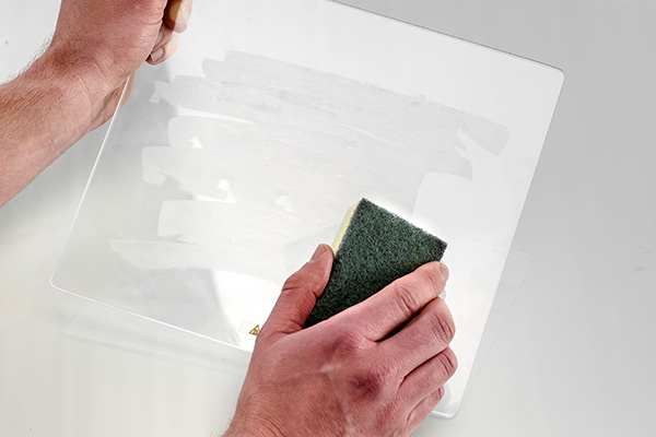

Glass build plate
For optimal adhesion of your prints to the glass build plate, it is important that the glass is thoroughly clean, or has a nice even layer of glue applied to it. It is recommended to clean the glass plate after several prints, or at least once a month.
Caution: Always make sure that the build plate has cooled down. Ensure the build plate is lowered to the bottom of the Z axis. Turn off the printer or ensure that the UltiMaker 2+ Connect cannot start a new print job before removing the build plate.
Before starting a new print, always check the surface of the build plate. At least once a month, clean the build plate thoroughly by taking the following steps:

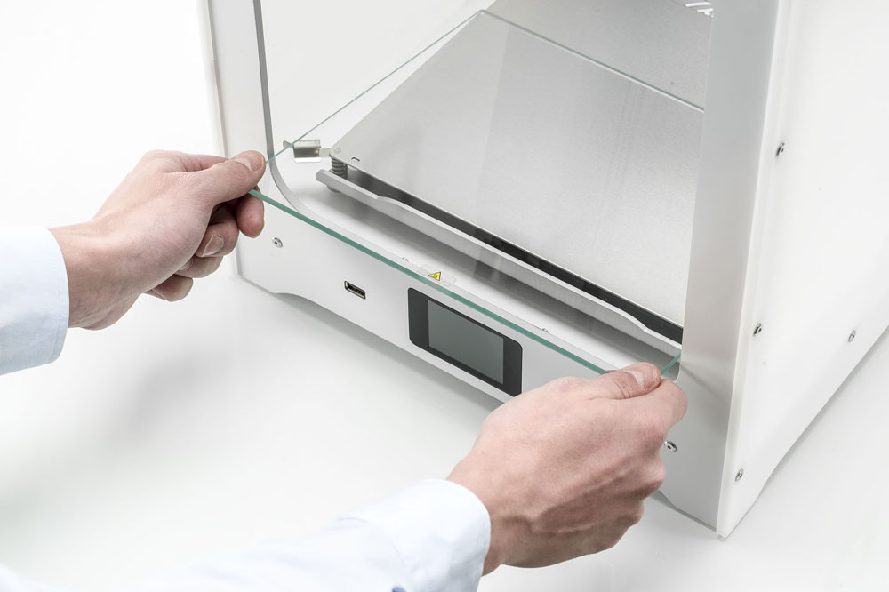

1. Remove the glass plateEnsure that the build plate is at the bottom of the printer. Open the two build plate clamps at the front and slide out the glass plate.
2. Clean with waterUse lukewarm water and a non-abrasive sponge to clean the build plate and remove any adhesives. If necessary, some detergent can be used to remove adhesives, or alcohol gel can be used to get rid of any fatty substances.
3. Dry the plateLeave the plate to air dry, or wipe it down with a (microfiber) cloth. Ensure that the plate is fully dry before reinstalling it in the printer.
4. Apply adhesiveFor most materials, it is recommended to apply a thin layer of glue to the glass plate. This improves the adhesion of printed models to the build plate. Alternatively, an adhesion sheet can be used.
5. Reinstall the glass plateSlide the glass plate back into the printer until it snaps into the build plate clamps at the back. Close the front two build plate clamps to secure the glass build plate.

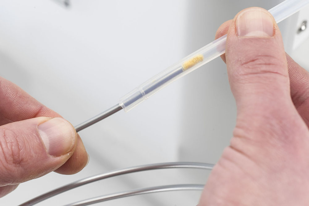

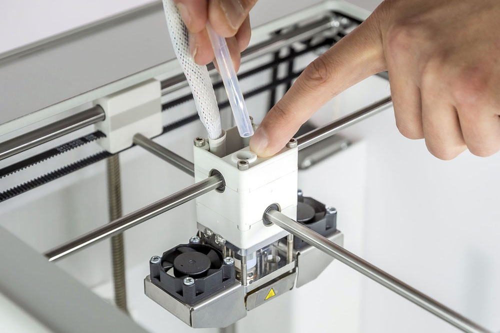

Bowden tube
Particles in the Bowden tube can impede smooth movement of the filament or mix colors. Clean the Bowden tube at least once a month, or after experiencing an issue with filament grinding. To clean the Bowden tube, it must be disconnected from the print head and feeder.
Caution: Turn off the printer or ensure the UltiMaker 2+ Connect cannot accept new print jobs through the Digital Factory.
1. Unload materialRemove the material from the Bowden tube. Navigate to Materials, then Unload material and pull out the filament (or check the in-depth instructions for unloading material on the UltiMaker 2+ Connect on this page).
2. Remove the Bowden tubeRemove the clamp clips from the tube coupling collets at the print head and feeder and pull out the Bowden tube from both ends. The cable clips that hold the Bowden tube to the print head cable do not have to be removed, you can leave them in place.
3. Clean the tubePush a small piece of sponge or tissue through the tube with a length of filament until it comes out of the other side. Ensure that any debris from the tube does not fall inside the printer.
4. Reinstall the Bowden tubePush the ends of the Bowden tube back into the print head and feeder. Ensure the tube is fully inserted and secure it with the clamp clips.
When the tube is cleaned and reinstalled, you can load the material again.
