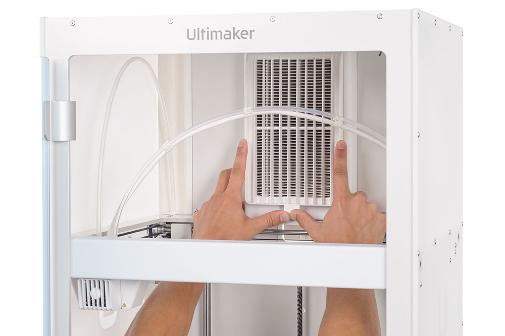

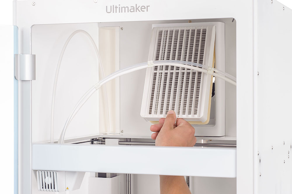

  1. Take out the used filter by pulling the tab on the filter towards you and removing it from the filter housing.
  2. Directly place the used filter in a (resealable) bag and close it.
  3. Insert the replacement filter into the filter housing and gently push it. Select Confirm when the filter is completely flush.
  4. Close the Air Manager to finish the placement and select Finish when done.
Remove-Air-Manager-filter.jpgInstall the new filter
Pull the tab to remove the used filterPush the new filter flush in the housing
