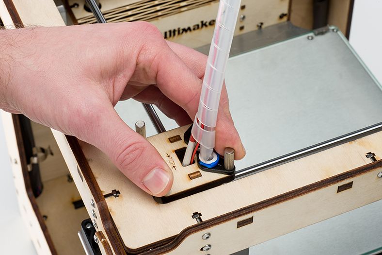

X and Y limit switches
During assembly, the switches were placed as far toward the inside of the printer as possible. This gives the highest chance that the switches will be correctly activated.
Place the print head in the center of the printer. Gently move it manually all the way to the front. Check that the Y limit switch (with the red wire, in the left panel) is activated before the print head hits the frame. You should hear a clear clicking sound.
Next, move the print head to the left to check the X limit switch (with the blue wire, in the front panel). Perform the same check.

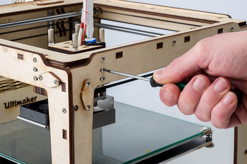

When the switches are not activated, loosen the bolts and place them further toward the inside of the printer. If this is not possible, you can carefully bend the switch's lever somewhat.
Manually move the print head to the Home position in the front-left cornerAdjust the switches' positions by loosening and retightening the bolts
