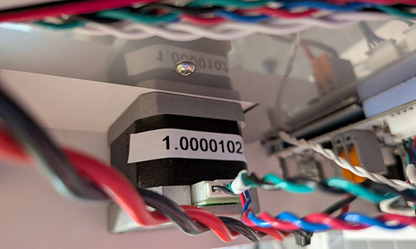

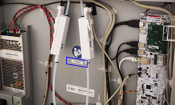

Each Z motor is already calibrated at UltiMaker's factory, using special equipment. This is done for the motors built into the printers and Z motors available as spare parts. This is where to find the correct scale values:
  • Factor Series: The Z spindle scale value for the original Z motor is on the back panel of the Factor Series printer, visible after removing the back cover panel. (see left image)
  • S6 and S8: The Z spindle scale value for the original Z motor is on the motor itself. This can be accessed by placing the printer on its side and removing the bottom cover. (see right image)
  • Replacement motors: For a replacement Z motor, the new calibration value is included with the motor.

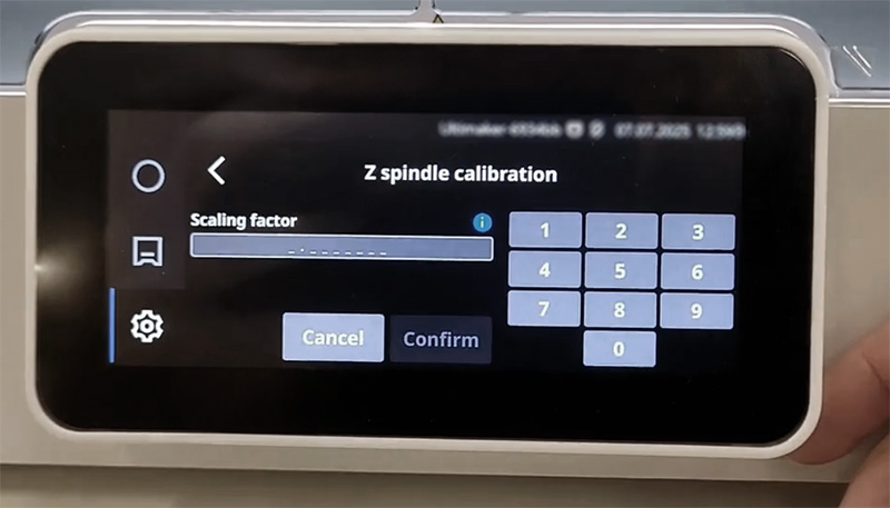

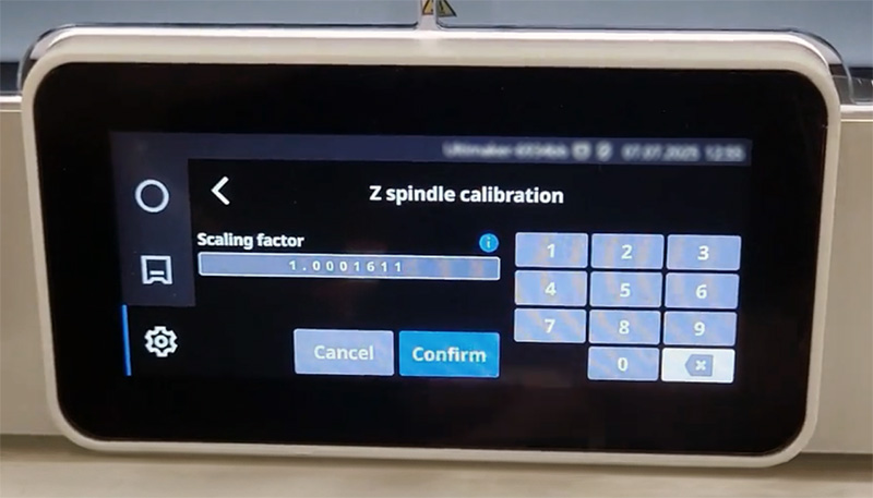

When prompted, find the Z scale option in the printer's menu. In the Options menu (gear icon), go to Maintenance → Frame & motion → Calibrate Z spindle scale.
The scaling factor is an 8-digit value, starting with '1' or '0' and 7 decimals. Enter all 8 digits in the menu and press confirm to store the information.
