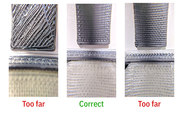

Test print
To ensure that the calibration is successful and the extruder alignment is good, run the calibration test print. You can find the model here.
Print the file with your build material and support material, using a default profile. After the print is complete, carefully remove it from the build plate to evaluate it.
Tip: Follow the checks listed below to check the calibration or watch this short video:
1. Check XY alignment
First, check if there are X and Y gaps between the model and the support material. The outer square should separate easily from the center. If the two materials are not well aligned, repeat the calibration process.
2. Check the sides
Remove the square piece on top and examine the sides. They should be straight. If instead they look flared, then your nozzles are too close. If they are rounded, then your nozzles are too far away.
3. Check the underside
Take a look at the underside of the top piece, and use the images below as a reference. You should be able to clearly see the extrusion path. If the lines look squiggly, the nozzle is too far away (left). If the lines are squished, the nozzle is too close (right).
Tip: If, based on these checks, you determine that your calibration is off, please run the calibration process again. Thoroughly clean the nozzles to ensure that they are 100% clean.
