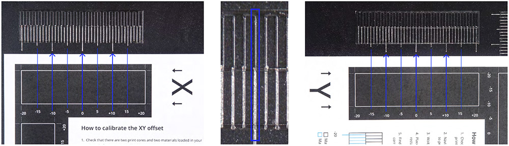

For the XY calibration, the UltiMaker Factor Series printer will run a short print with both cores, after which you are asked to select the printed lines with the best alignment. The XY calibration will take about 10 minutes.
You will need the XY calibration sheet, which is included in the accessory box. If you no longer have this sheet, you can download it here. Print this file on an A4 paper at 100% scale, or simply use it as a digital reference.
Note: The UltiMaker Factor Series printers include a paper XY calibration guide. Unlike for printers with a glass build plate, for Factor 4 and Factor 4 Plus, this sheet cannot be placed under the build plate to align the grids. The sheet is meant as a reference for which the X and Y grids are, and which numbers the lines in the grids indicate.

  2. A grid pattern will be printed on the build plate. Wait until it is complete.
  3. Once the build plate has cooled down, remove the flexible build plate from the printer.
  4. Find the best-aligned lines on the printed X grid and note which number corresponds to these lines. Enter this number as the X offset value on the display.*
  5. Find the best-aligned lines on the printed Y grid and note which number corresponds to these lines. Enter this number as the Y offset value on the display.*
* Tip: In some cases, it can be difficult to determine the best-aligned line. When in doubt between, for example, the lines corresponding to +1 and +2, enter +1.5 in the menu.
