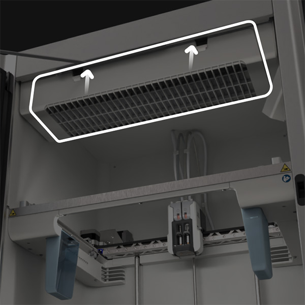

  3. Open the build chamber glass door.

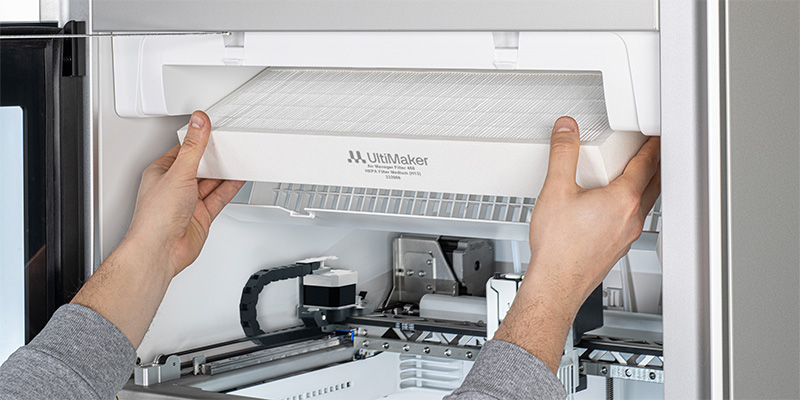

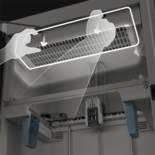

  4. Press the tabs at the front of the filter box to release the latch and open the filter box.
  5. Carefully take out the used filter.
  6. Directly place the used filter in a (resealable) bag and close it.

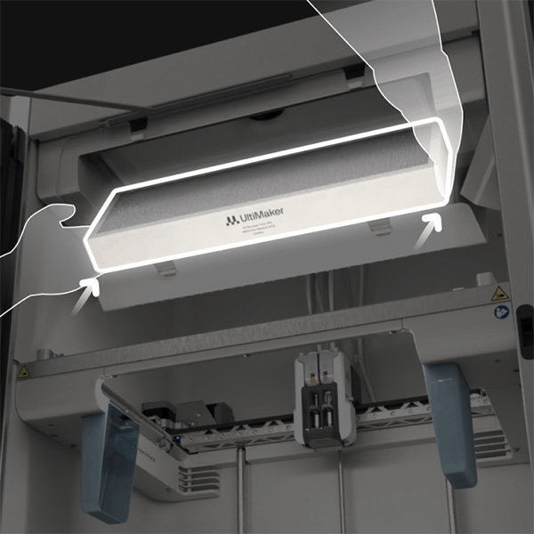

  7. Place the new filter in the filter box, and push upwards to close the filter box. It should firmly click into place.
