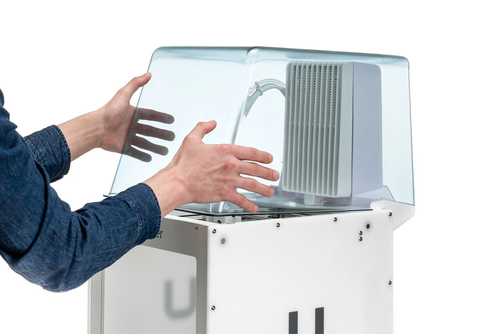

  1. Remove the Air Manager cover.

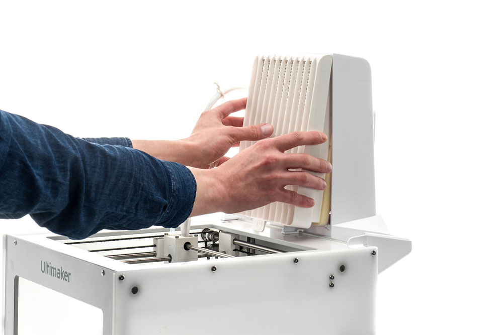

  2. Take out the used filter by pulling the tab on the filter towards you and removing it from the filter housing.
  3. Directly place the used filter in a (resealable) bag and close it.
  4. Insert the replacement filter into the filter housing and gently push it. Ensure the filter is completely flush.
  5. Place the Air Manager cover onto the printer and turn on the UltiMaker 2+ Connect.
