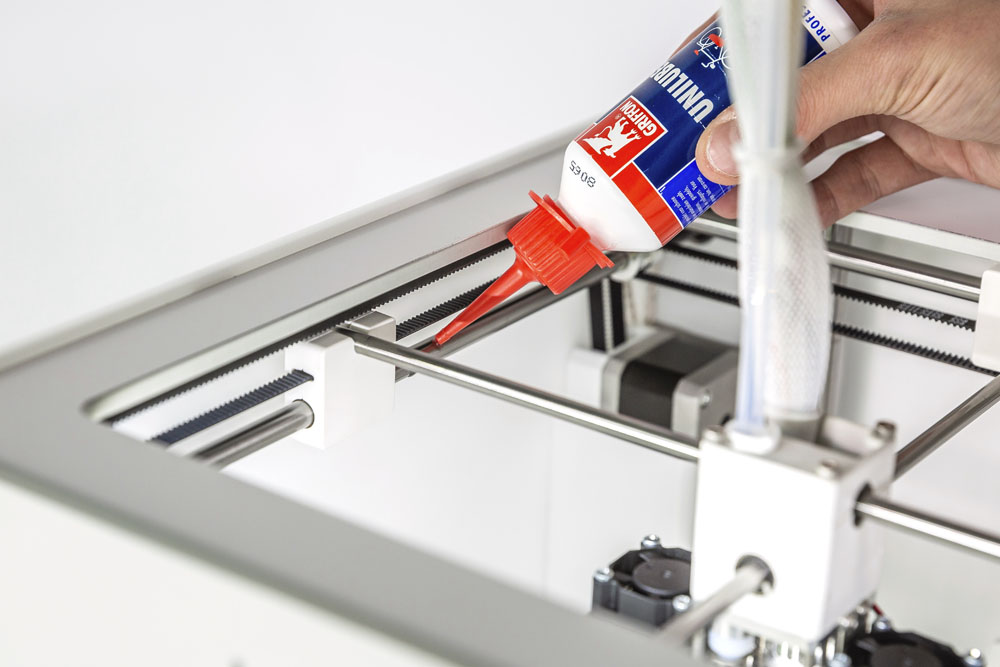

X and Y axles
Apply a small drop of oil to each of the X and Y axles as well as both print head shafts. Manually move the print head around to evenly distribute the oil.
Do not apply too much oil to the axles, as it might drip from the axles onto the build plate, which will affect print adhesion. If a drop of oil falls on the build plate, clean it thoroughly before printing.

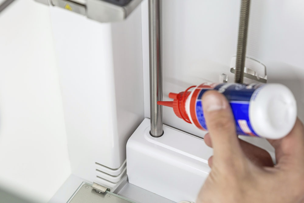

Z axles
Apply a small drop of oil to each of the Z axles. Move the build plate up and down to evenly distribute the oil. This can be done manually, or through the Maintenance → Move build plate menu.
Do not apply the oil to the Z motor's lead screw. This must be lubricated with the supplied grease once every three months.
Note: Never use the grease (Magnalube or Eurol) on the smooth axles of your printer. If you have done so accidentally, make sure to thoroughly clean the shafts before applying the oil for relubrication.
