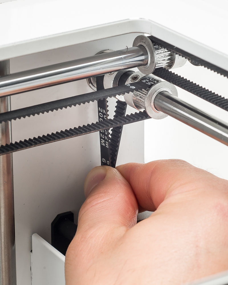

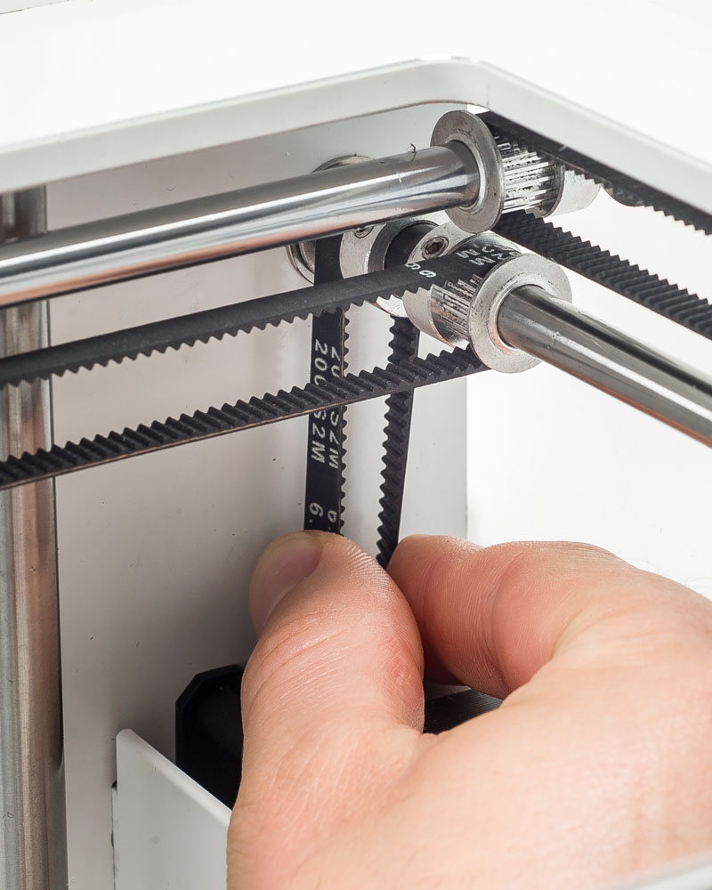

Pluck the two short belts to check their tension. They should resonate, like guitar strings. It should not be possible to press the belt against itself. Furthermore, the tension of the two belts should be equal.
Correct belt tensionBelt too loose

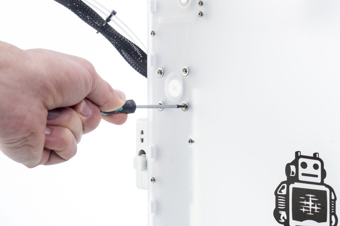

To restore the tension, adjust the motor position, following the steps below. Use a 2 mm hex screwdriver or the hex key from the Ultimaker 2+ accessory box.

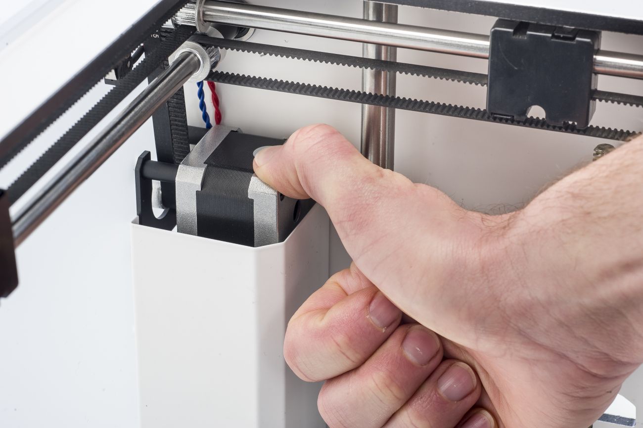

  1. Loosen the Y motor by using the hex screwdriver to loosen the four bolts that hold the Y motor to the left panel. Only loosen the bolts; do not remove them. The motor should be able to slide up and down.
  2. Firmly press down on the motor with one hand. This ensures maximum tension on the short belt.
  3. While still pressing the motor down, tighten the four bolts of the Y motor in a cross pattern. First, tighten the top-left bolt, then the bottom-right, followed by the bottom-left, and ending with the top-right. This ensures that the motor is attached straight.
  4. Perform the above steps for the X motor that is attached to the back panel. Afterwards, check the tension of both belts again.

Firmly push down on the motorTighten the motor bolts in the frame
