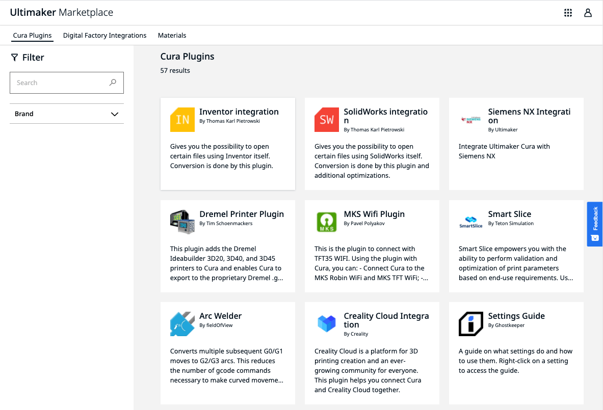

The UltiMaker Marketplace lets you add extra functionality to UltiMaker Cura and streamline your 3D printing workflow. This includes plugins such as the Solidworks, Autodesk Inventor or Siemens NX integration: plugins which export files to UltiMaker Cura directly from your favourite CAD software. You can also find optimised material print profiles for third-party materials that are designed to work with UltiMaker 3D printers.
Access the UltiMaker Marketplace from the top menu bar in UltiMaker Cura, or visit our marketplace webpage.
Continue reading to learn more about plugins and materials.
Cura Plugins
Plugins add extra functionality to the software.
Click on a plugin to learn more about it. Read the description, visit the website of the developer and view the plugins change log.
Tip: Look for the Verified plugins icon. While all plugins are reviewed by our developers, some plugins go through an extra verification step making sure they are reliable enough to be used in enterprise software. We mark those plugins “Verified” and are recognisable by the circled 'v' icon. Have a look for instance at the Solidworks or Siemens NX integration plugin

From UltiMaker Cura, simply open the marketplace using the Marketplace button in the top right of the user interface. The marketplace panel will be displayed, from there you can search for plugins and materials. Click on a plugin or material to learn more about it, and simply click Install to add it to Cura.
You can find all the installed packages under the manage packages section accessible trough the gear icon.
