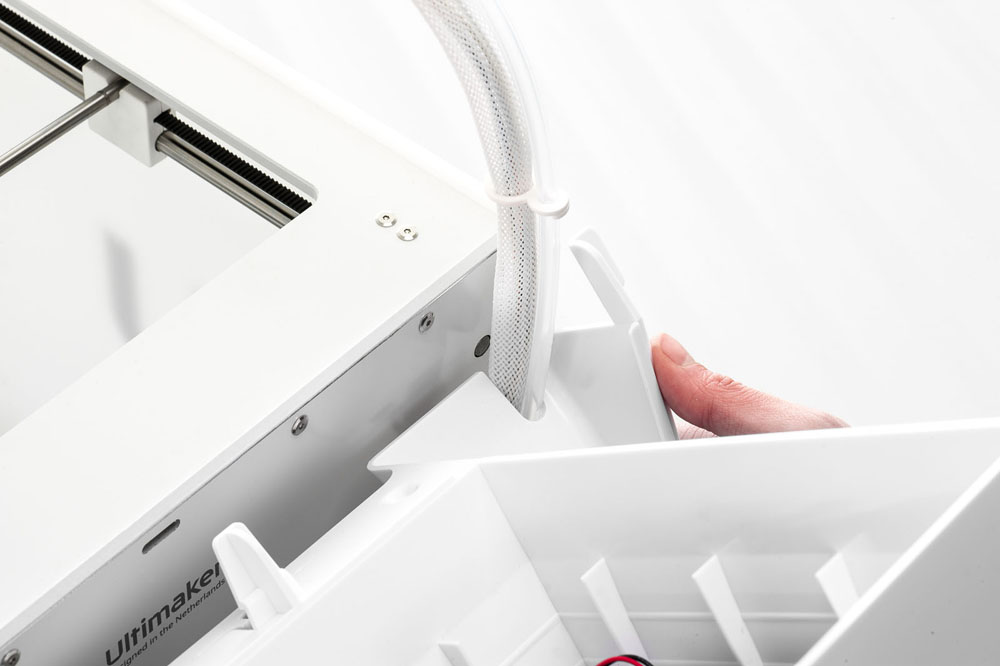

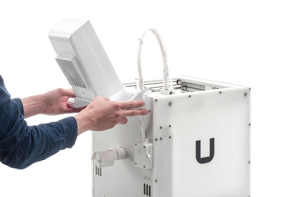

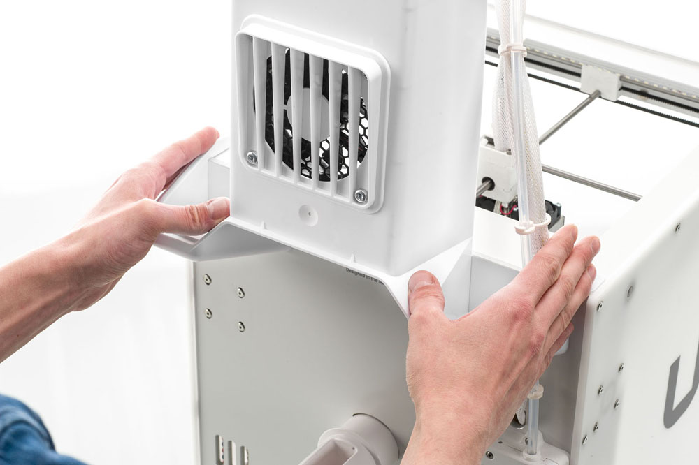

  1. Align the filter housing with the back of the UltiMaker 2+ Connect.
  1. Guide the Bowden tube and print head cable into the slot.
  1. Push down on the filter housing until it clicks firmly into place

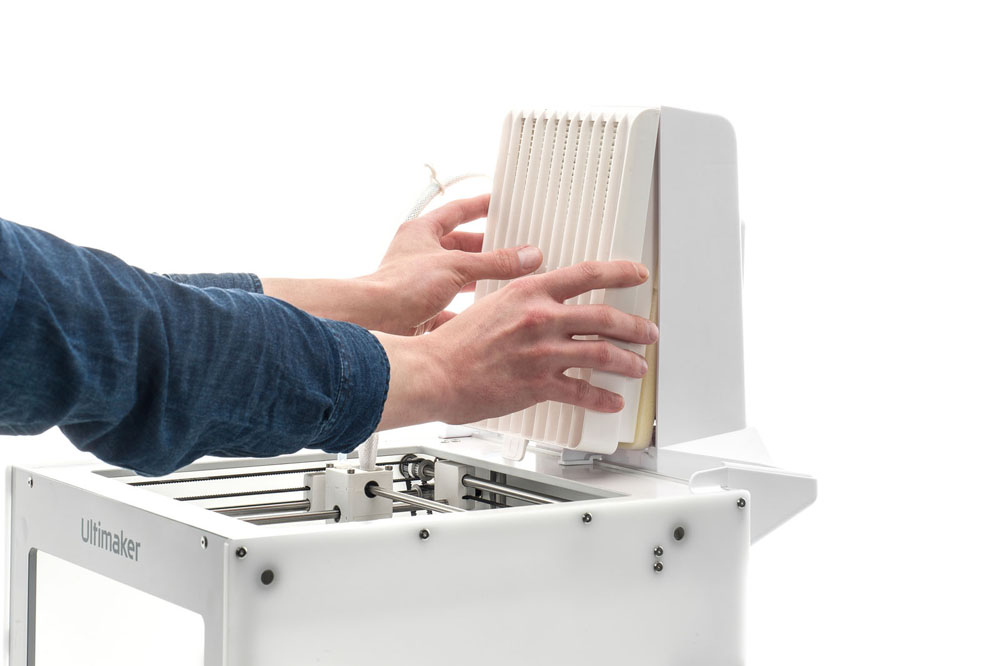

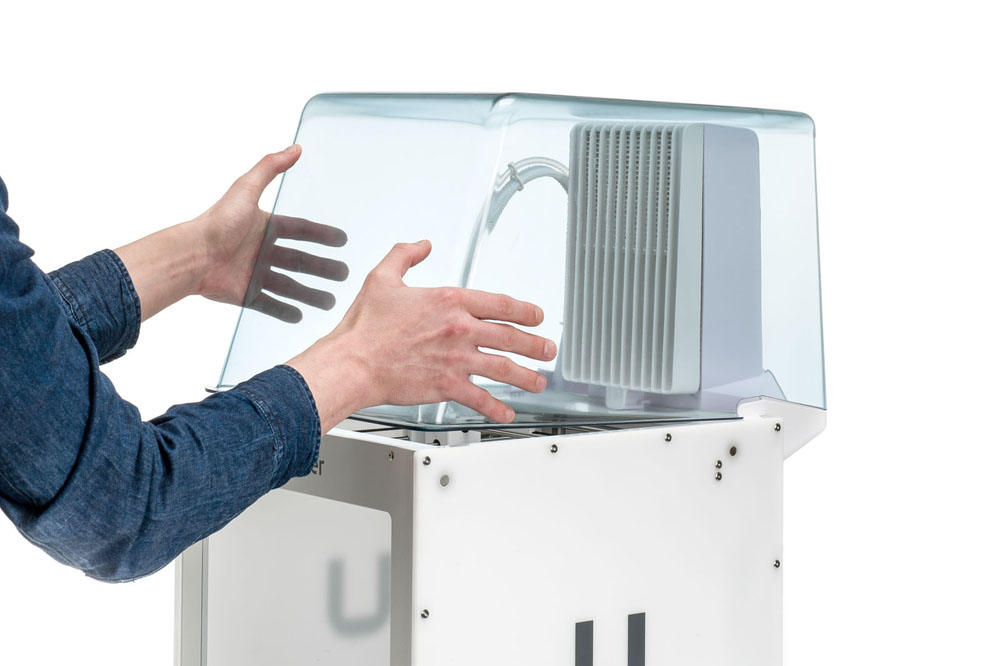

  1. Gently push the filter completely into the filter housing, with the tab facing down
  1. Place the cover over the filter housing and align it with the top panel; ensure there are no gaps between the cover and the printer.

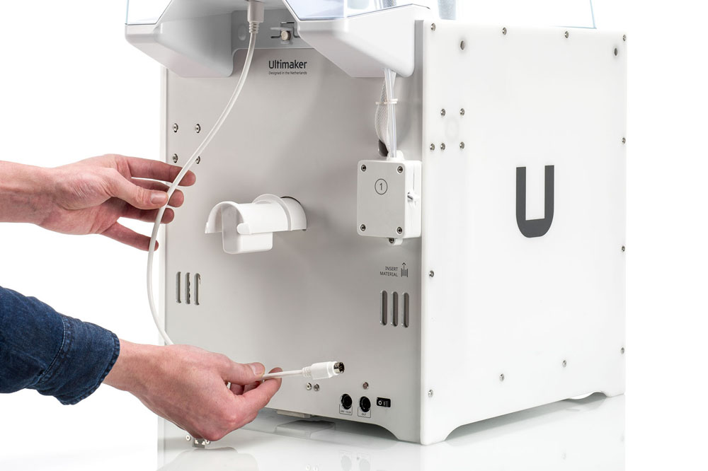

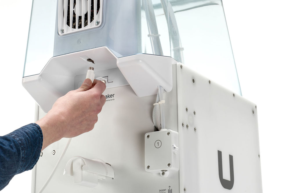

  1. Connect the Air Manager cable to the port at the back of the Air Manager and secure it with the clip.
  1. Guide the Air Manager cable around the left side of the spool holder.

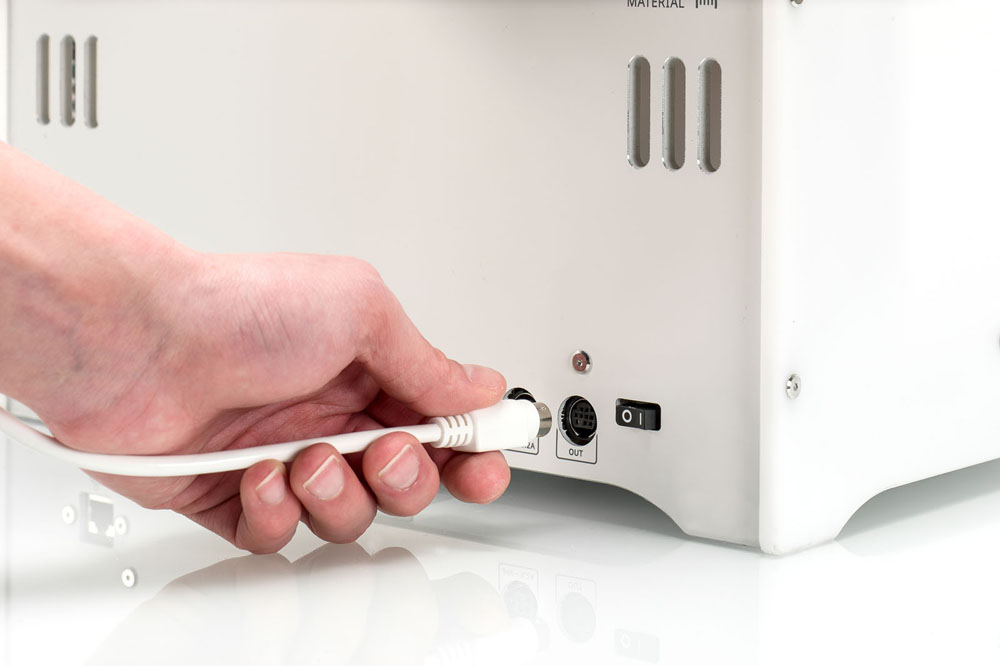

  1. Plug the cable into the OUT port at the back of the UltiMaker 2+ Connect.

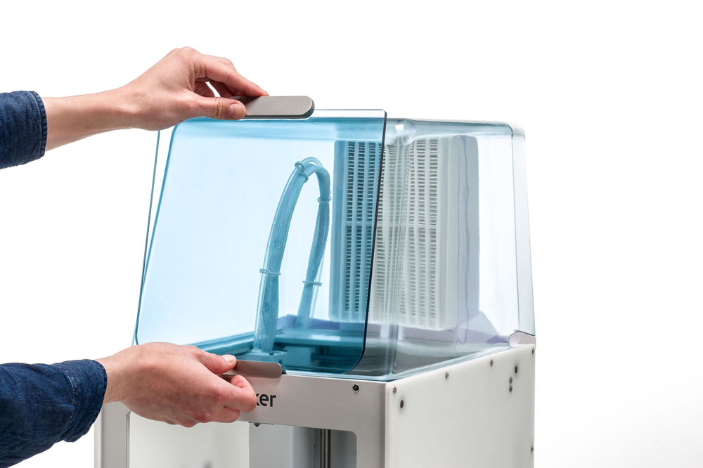

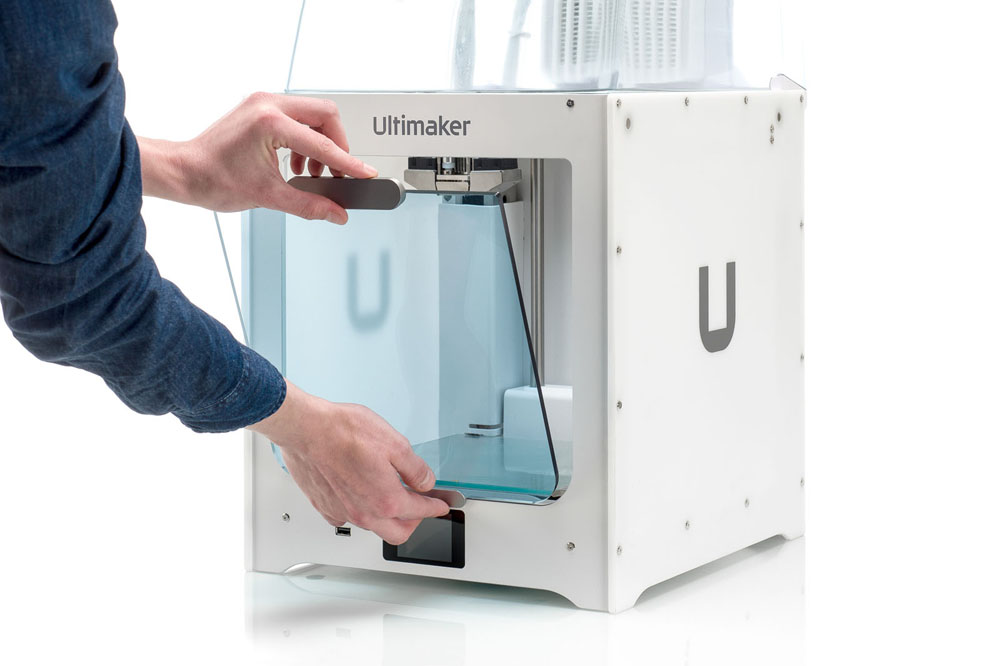

  1. Take the front enclosure and place the hinge profile on the front panel.
  1. Push the handle against the panel; the magnet will hold the front enclosure in place.
Note: The UltiMaker 2+ Connect and Air Manager must be positioned out of direct sunlight when in use. Ensure there is at least 10 cm of free space at the back of the Air Manager for unrestricted airflow.
Front enclosure
The front enclosure must be installed when the UltiMaker 2+ Connect is printing. To remove the print, or for certain maintenance procedures, the front enclosure must be removed. This can be conveniently placed on the top of the printer, resting against the Air Manager cover.
