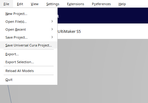

When you find the right orientation, and print settings for your model and you are ready to distribute your model, go to File, Save Universal Cura Project

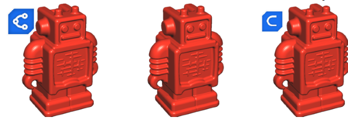

A Universal Cura Project has the file extension .3mf. On Windows, they can be distinguished from regular .3mf files by their preview.
  1. A UCP, only model settings, will have a UCP logo in the top left corner
  2. A 3D object, no settings will have a plain preview
  3. A Cura Project File, printer, and material settings, will have a Cura logo in the top left corner
